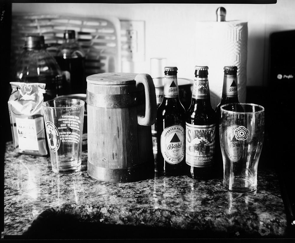

Shhh. Don't tell anyone. I scan mine, clean them up in photoshop and then have them printed by a lab.
Here's the 3 minute exposure from this afternoon. When you're playing with paper, watch the contrast - paper doesn't behave like film.
