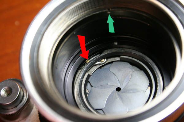

A portion of the inner wall of the lens, just behind the front element, seems to have a mechanism that controls how much the lens is stopped down when the button is pressed. Presumably it is controlled by the aperture ring; but currently no such connection, if there is one, is functioning.

Ok. So the red arrow points to a lever which rides on a ramp. This controls how far the diaphragm opens when the button is pressed. If the lever has somehow slipped off the ramp then turning the aperture ring (which is connected to the ramp) will not change the diaphragm size. If this is the case get the lever to ride on the ramp and check that the lock ring (green arrow) is not loose.

On mine, the aperture ring doesn't move the ramp or the inside sleeve that it is connected to (just inside from the lock ring, about where the tails of your arrows are). The lock ring is indeed not loose; I can't even get it to budge.

Unfortunately I can't find my jewellers screw drivers to take mine apart any further. I suspect that if you loosen the remaining set screws on the aperture ring you can remove it, it should be engaging the sleeve in the picture that you mentioned via a screw or peg. It's possible somebody took it apart previously and just didn't put the parts back together correctly. Otherwise it's broken. That's all the help I can offer unfortunately.

It isn't engaging that sleeve at all, so I assume it is indeed broken. I'll compare it to the lens on my other Miranda to confirm that. I'll continue to check on eBay for a replacement. Thanks very much for your help!
