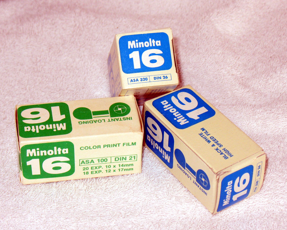

I have a 3 new-original-stock cartridges, with box and still in sealed "coffin". I have some used ones that would be cheaper, but they won't be accessible to me for a couple of weeks. PM me if interested.
