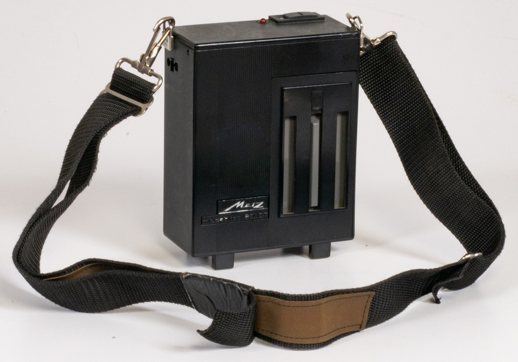

Hi Per,
Here's what I've got. The battery is kaput. How can I tell if the capacitor is OK?
TOMView attachment 249129
If you have a 6v sealed lead acid battery, you could jumper from the leads inside the unit to that battery. That will test the charging circuit. But if the capacitor is part of the flash circuit (and I suspect it is) you won't be able to test without a flash head.
My head won't power up. I don't have a spare 6v lead-acid battery. Would any 6VDC source work?
I THINK any 6v dc source (even 4 1.5v AA batteries in series) would work to fire the flash at least a couple of times. I base this on the fact that others (including the OP) are using a Li-on battery for powering. However, that charging circuit will likely not work with anything other than a SLA battery.
Yes attaching 6v to the housing internals should work fine.
