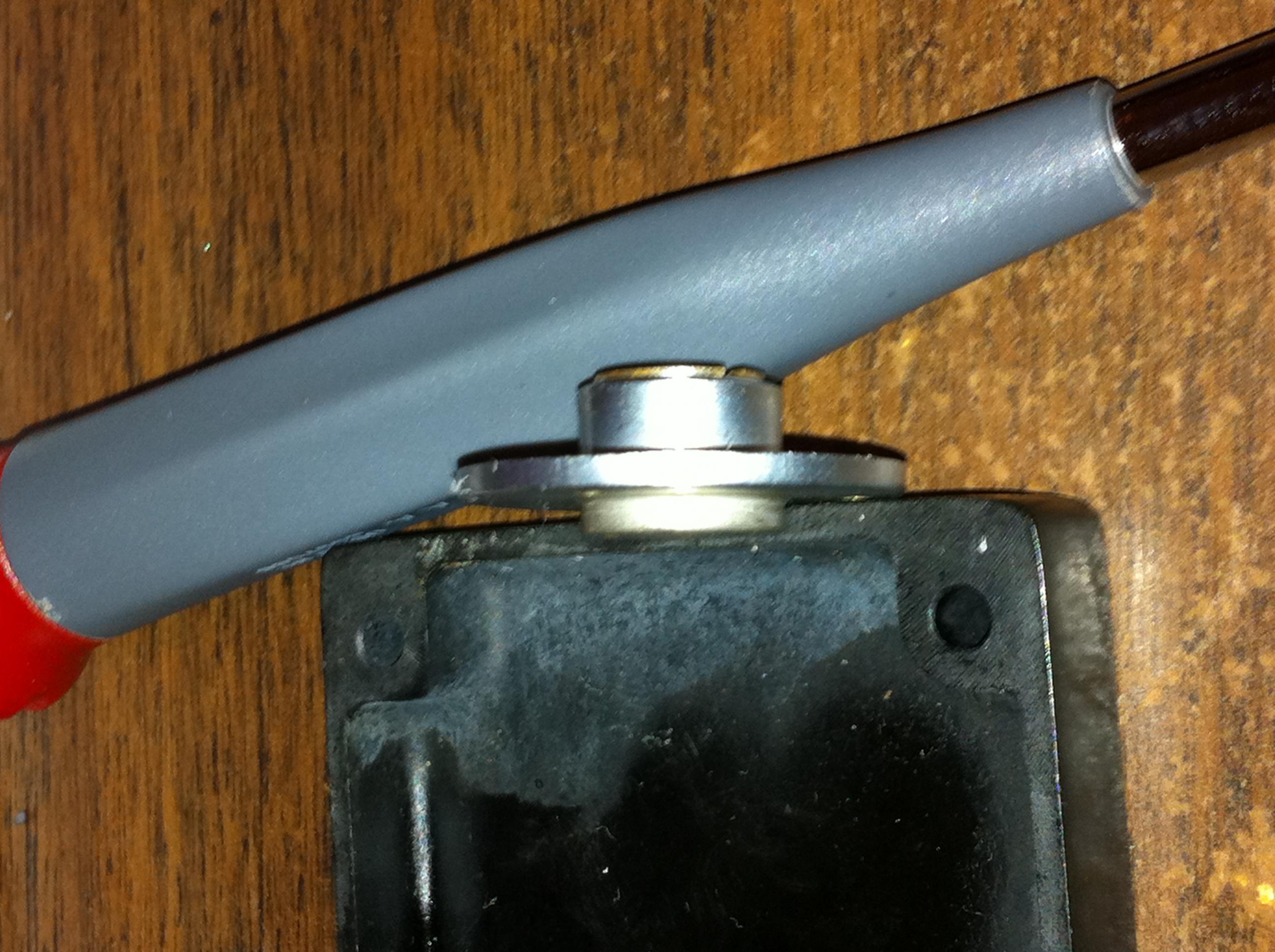

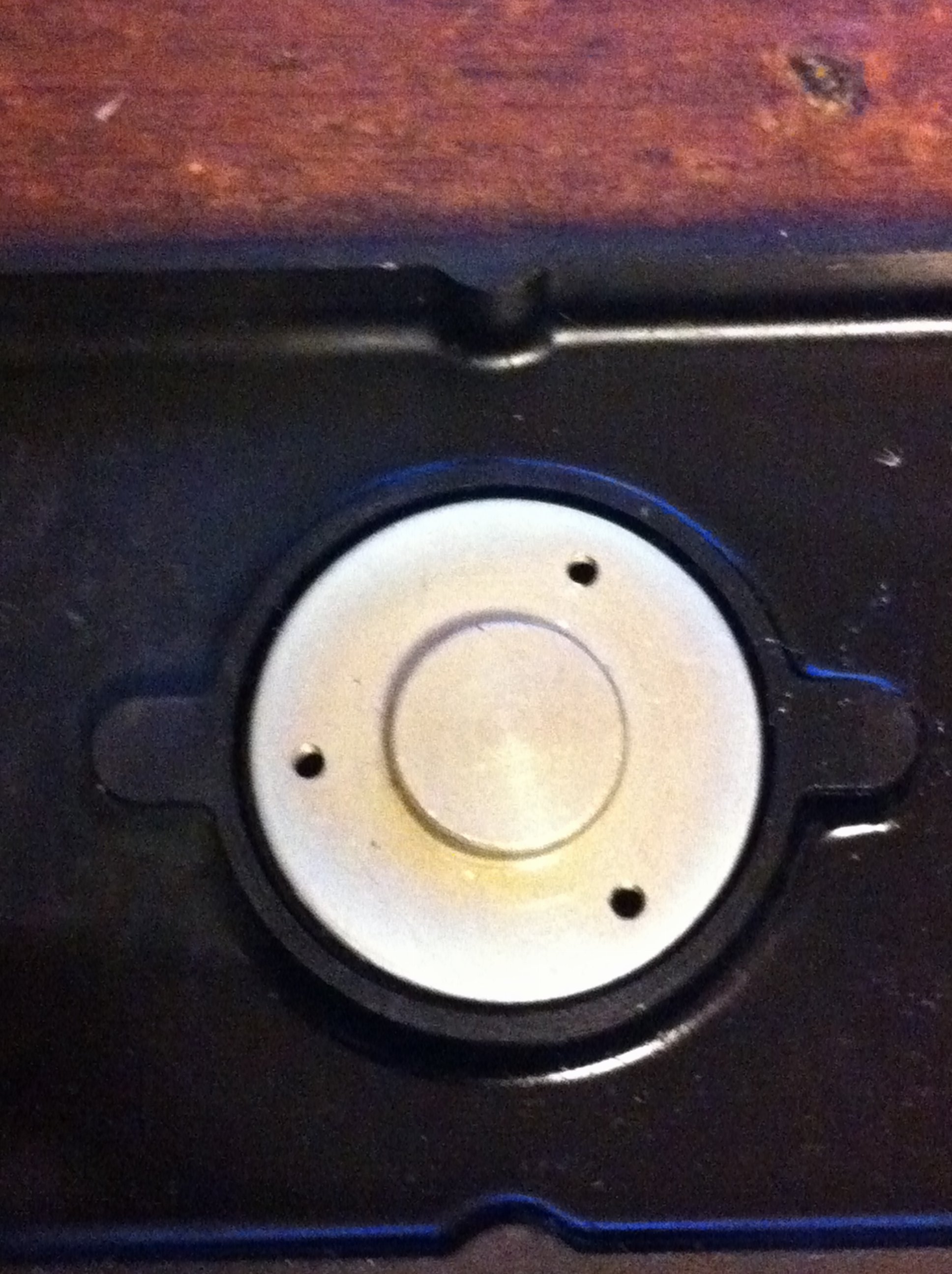

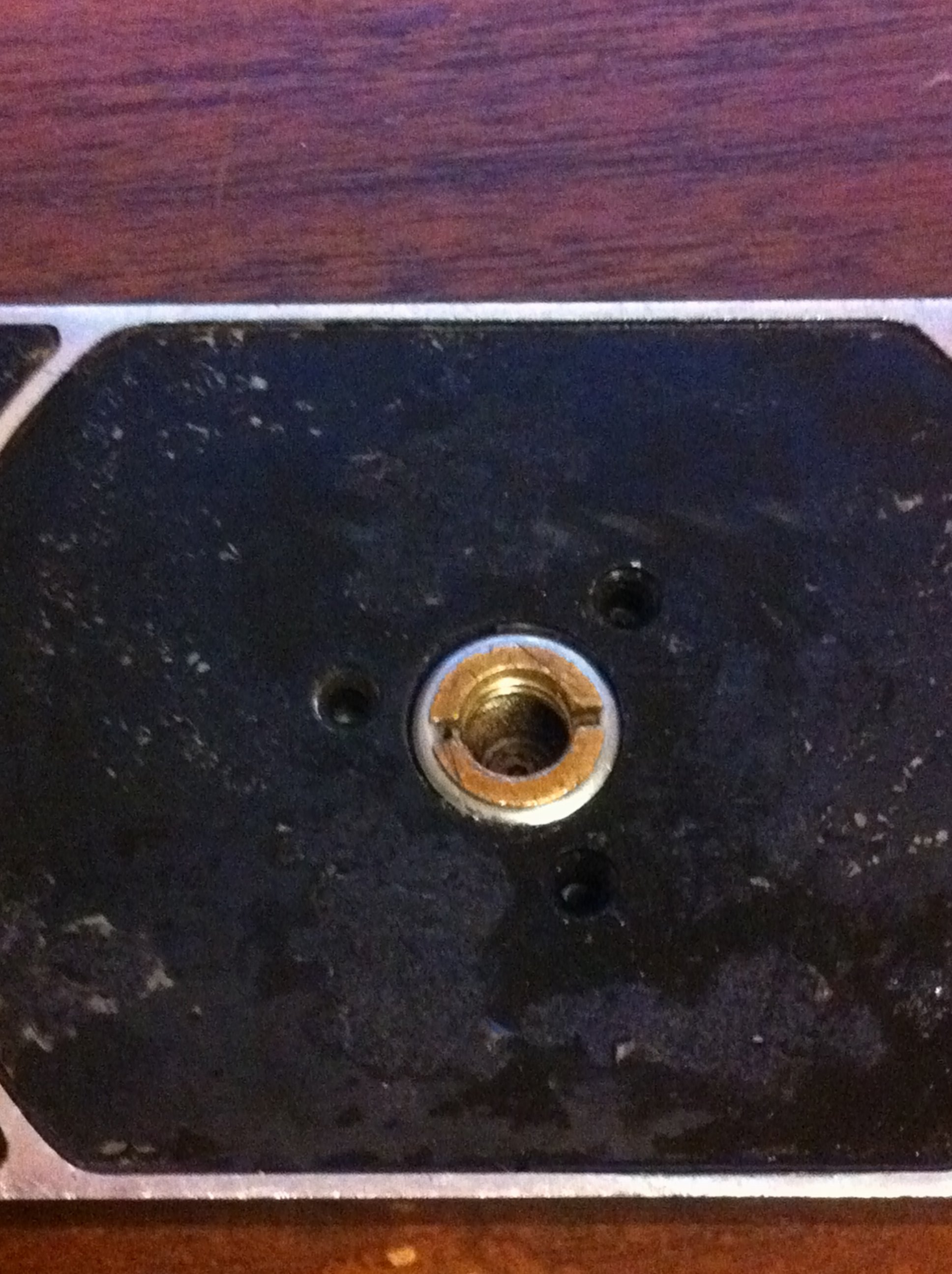

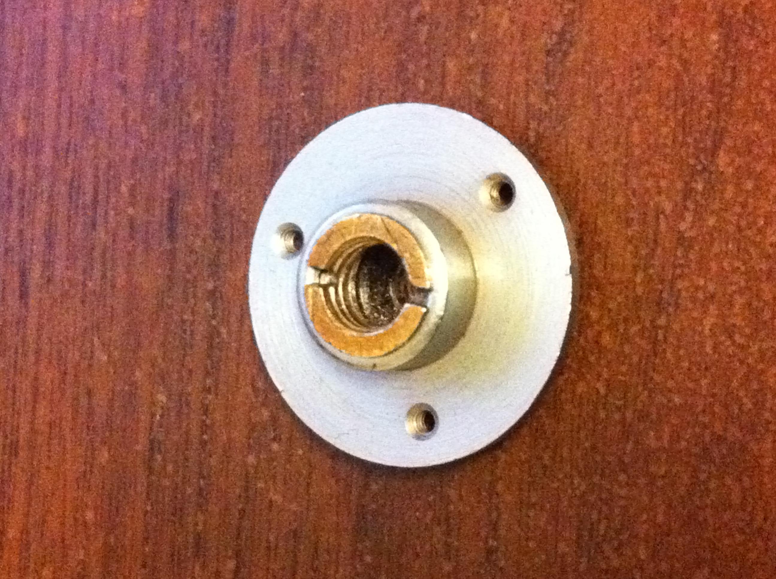

Thanks. I'm not mechanically inclined enough to even understand some of what's discussed in that thread, but it is easily removable. I already have the plate and socket off. A local machine shop might well work. For that matter it looks like it might already have a threaded 3/8s to 1/4 insert installed and that's what stripped. If so I can get another off eBay, provided I can get this one out. Looks like I need either a larger screwdriver than I have or a small spanner (which I also don't have - the three lenses I have came with the camera already mounted on boards so a spanner has been something I've been meaning to buy for something like 15 years now.) It looks somewhat like the T-nut in C in the link, but the body is shorter. This length needs to be right to fit through the base plate properly.
Here are some photos. First is the tripod socket removed from the base plate. Second is the socket seen on edge to give an idea of the thickness and the third and fourth are the socket in the baseplate showing how it fits, minus the mounting screws.
EDIT: Well it scrambled the order as usual but it should be clear enough which is which.

I think you're right... you just need a new threaded insert. I'll bet your local automotive mechanic would remove that for you for free... during a slow time for them. A new insert is only a couple bucks.
