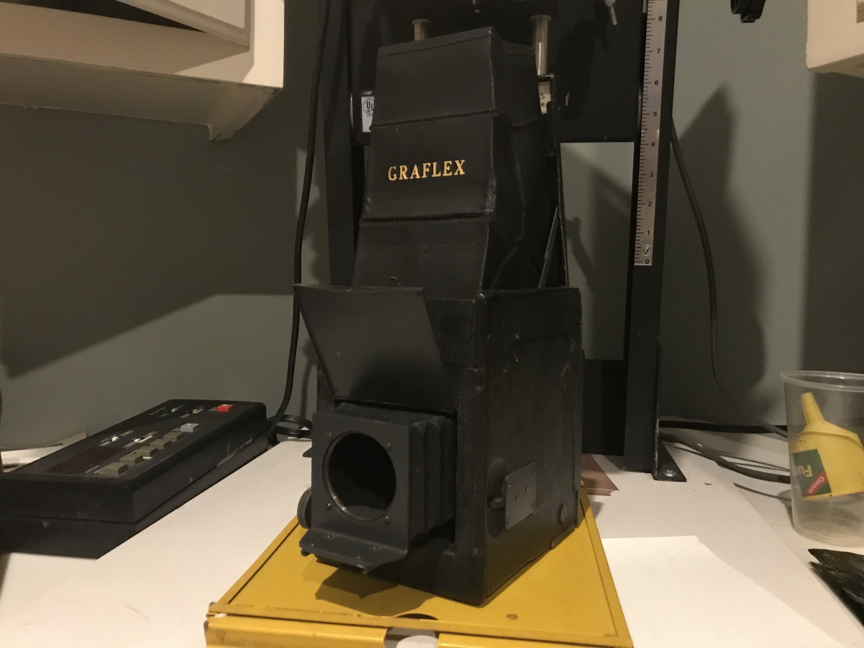

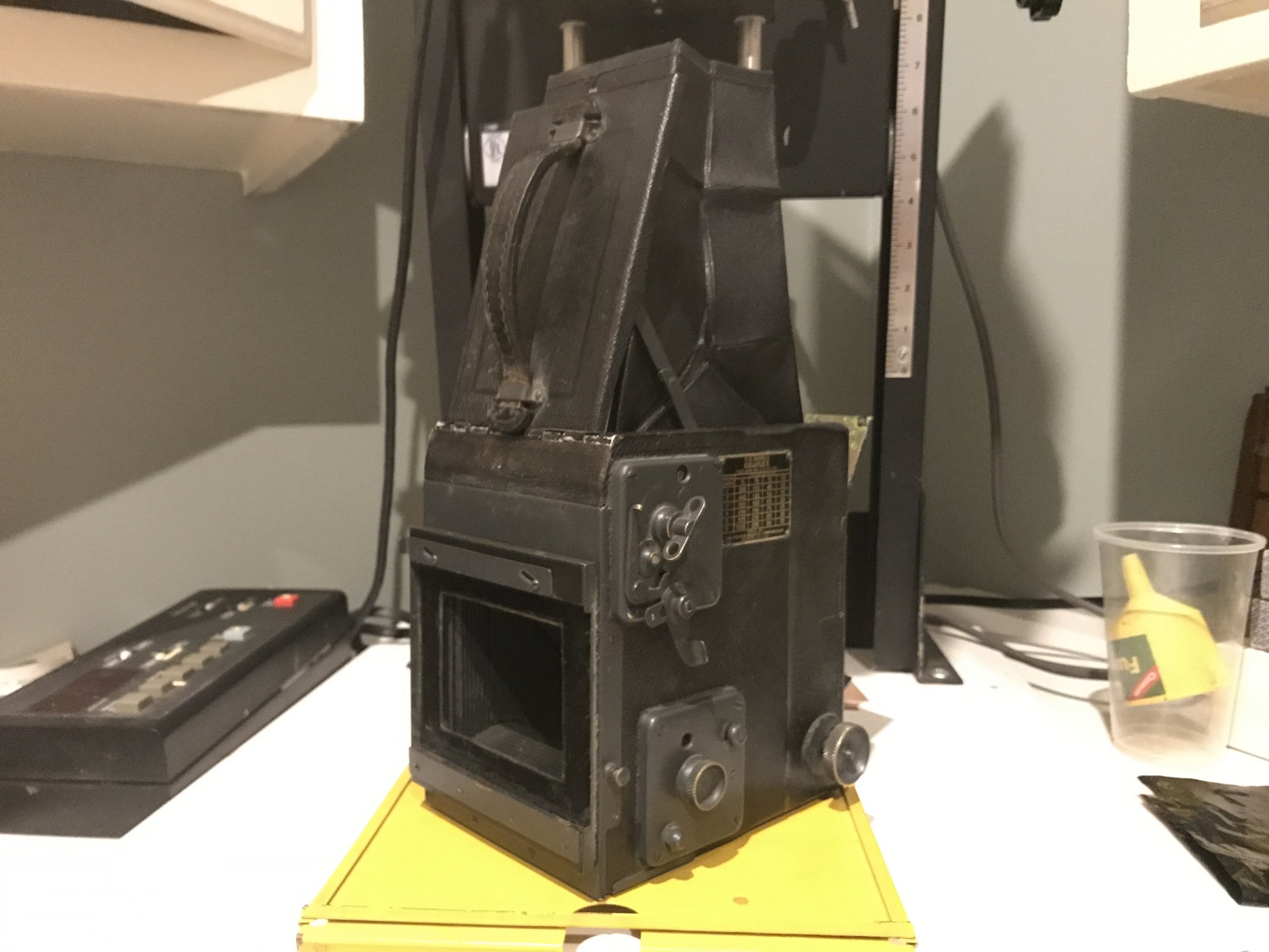

A friend is moving out of there house and into a bus soon. They could not keep all the decorations in the house, and knowing I enjoy older cameras, they gave me a graflex rb series b 21/4x31/4 camera. The camera is missing a roll film back, and a lens. The rest of the camera seams to be good. The shutter seams to be working perfectly and the mirror and such work as it should. The back will probably be hard to come by as its the graflex back and I would like to get the correct 2x3 back for it. If need be I might just modify a graflok style back and make it work. The lens I think should be a kodak ektar 127 4.5 barrel lens but Im not sure and and don't know the history of graflex slr very well.
If anyone can help me out, it would be awesome to get this old camera fully operational again, or any insights into what lens should be on the camera.
Here are some pictures of the rb series b

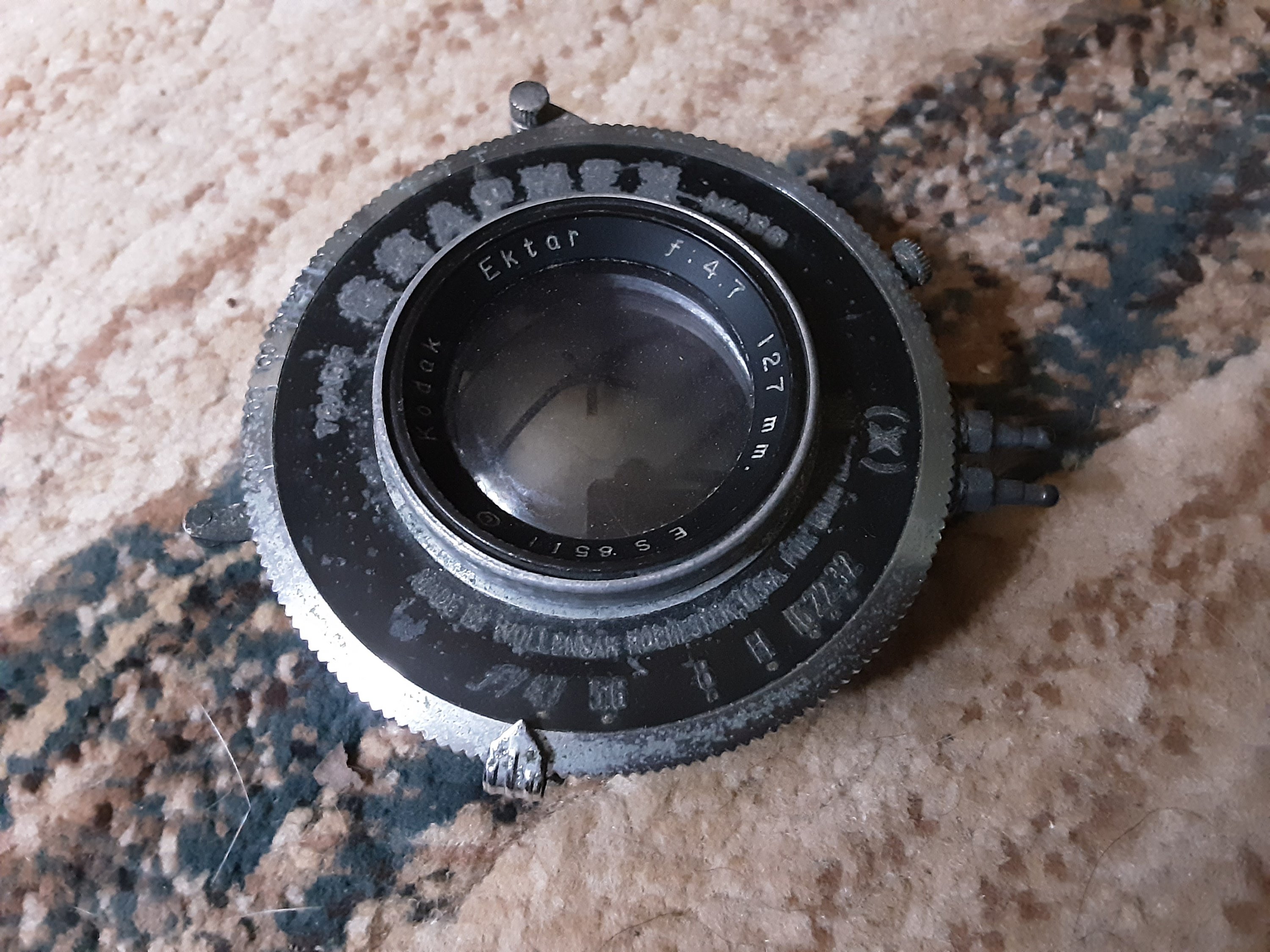

I have a Graphex Ektar 127 4.7 in shutter . It's not in great shape, though the T setting does work. I guess it would depend on whether you want a shooter or a 100% correct restoration. Given it's condition, I'll let it go pretty cheap.
Im looking for the barrel mount lens, with the correct thread. That lens will not mount up to the camera without modifications

View attachment 279356 View attachment 279357
I have the same camera. The correct lens is either the the 127mm Ć’4.5 Ektar barrel lens or the #31 Kodak Anastigmat barrel lens, depending on when the camera was made. I think that the lens mount is the same for both lenses. Regarding any roll film backs or sheet film holders, make sure that they are for "GRAFLEX" backs, not "GRAPHIC" Backs. This is very important. Graflex made two kinds of camera backs and they are not interchangeable. Good luck getting the camera going, they are fun cameras.

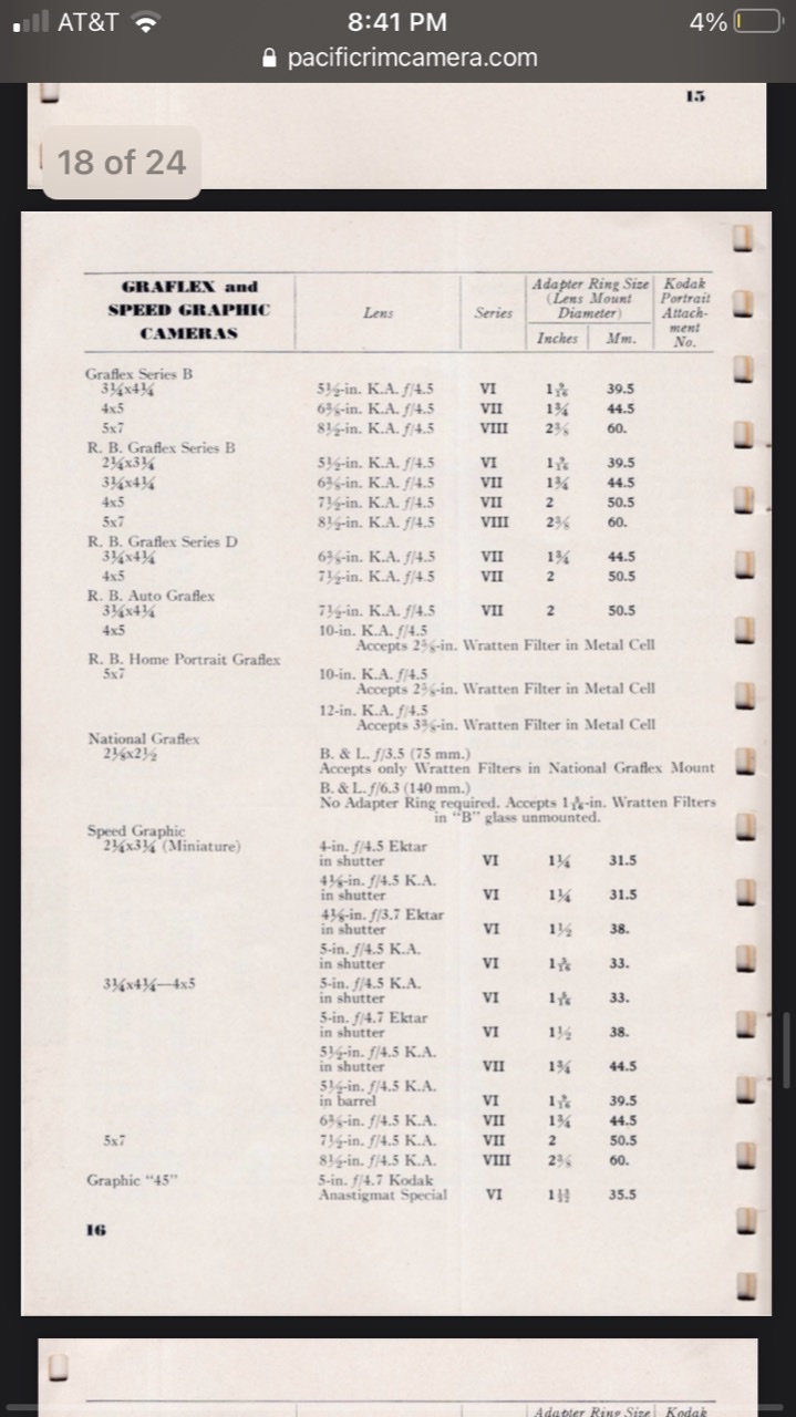

By this i found, it should have a 39.5 flange for the lens. I put my calipers on it. Just measuring the opening size, it is 43mm. I might be measuring wrong but.
By this i found, it should have a 39.5 flange for the lens. I put my calipers on it. Just measuring the opening size, it is 43mm. I might be measuring wrong but.View attachment 279426
Double check that. In the descriptive part of that document and other Kodak publications they are more clear that they refer to the adapter for lens accessories like Series filters and hoods..
I could be wrong also... I can't pull mine out right now to measure and verify. Maybe tomorrow. I'm puzzling through this with you with a Number 34 I have but need a mounting flange.
