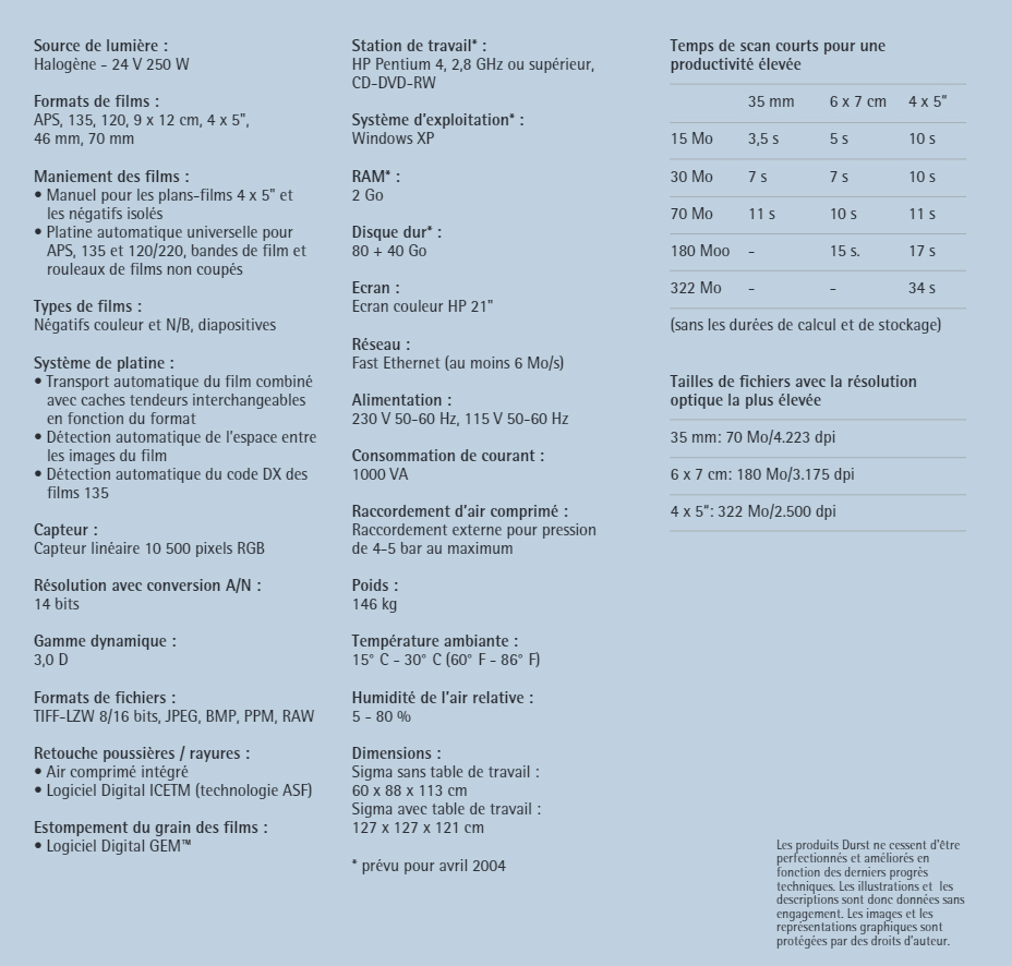

Is it nearer 200 or 300lbs? I've never been able to find either a weight or size spec for one. Numbers I've seen indicate 3800ppi for 135, 3000ppi for 120, 2500ppi for 4x5.
I wonder if the scan size limits are partly for speed & partly so that it doesn't hit limitations of 32-bit file formats - it could feasibly scan the entire roll as one big file at blazing speed, then break it up into individual files afterwards. I'd be really interested to see any of the manufacturers' documentation.

For those who are interested & can read French, here's the production specs of the Sigma Plus
I really don't want to sound like Mr Grumpy, but just to make things crystal clear, I've long had a commercial case for buying one of these machines, however they always seemed to have about the same prevalence as hen's teeth in the UK so I never went seriously looking for one. On the other hand, I found a 105mm Rodagon-G pretty much immediately, so sometimes luck can strike...
I would be interested to see what the user interface offers in the way of controls & whether a user generated LUT could be used to define colour inversion etc - and whether the TIFF is uncompressed or LZW only.
