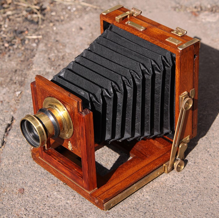

Hi all,
I'm looking for a set of 6x6 replacement bellows. I'm working on a project which requires a set of bellows like what would come on a common set of macro bellows for 35mm but slightly larger (basically the size of medium format macro bellows). I've looked at a few options such as replacement bellows for Hasselblad Arc Body and Flexbody cameras, bellows from a Pentax 67 macro bellows, bellows from Mamiya auto bellows etc. The problem is everything I can think of comes from an expensive source. I'm wondering if anyone here as set of square medium format size replacement bellows available. Please let me know. Thank you!

I have a set off a Durst enlarger, I'll see if I can find them later (this evening UK time). The other option is make some it's not that difficult these are a set I made for my Quarter plate camera, a non tapering set is easier still. Total cost less than $10 and that's with materials left over for more.

I make my own materials, I restore focal pnae and other curtain shutters and make my own shutter cloth and essentially used this for my bellows.
It's very simple, I use black acrylic paint to seal and make thin black material light-tight, I work it into the cloth wiping off excess - this part is important for best flexibility. I've used 4 different Acrylic paints up to now, while all are fully light-tight I prefer one variety for shutter curtains as there's better flexibility, and another for things like bellows where the finish is more silk like (as opposed to matt). I do use the matt finish on the inside of bellows. It's aslo usefull for restoring bellows.
I found you needed to look at a few website for bellows making, none was quite right, I tend to make a paper version first, and now have my patterns drwn up in CorelDraw which I just adapt as needed.
