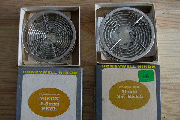

Those definitely show up on that big auction site from time to time. You basically have to just search on "Nikor" and wade through all the results though, since a lot of sellers don't know what they have, and you just have to spot it. It's a slightly goofy looking reel, with the classic spiral wires only on one side, and just radiating arms on the other, with a little lip at the edge to keep it from falling out.

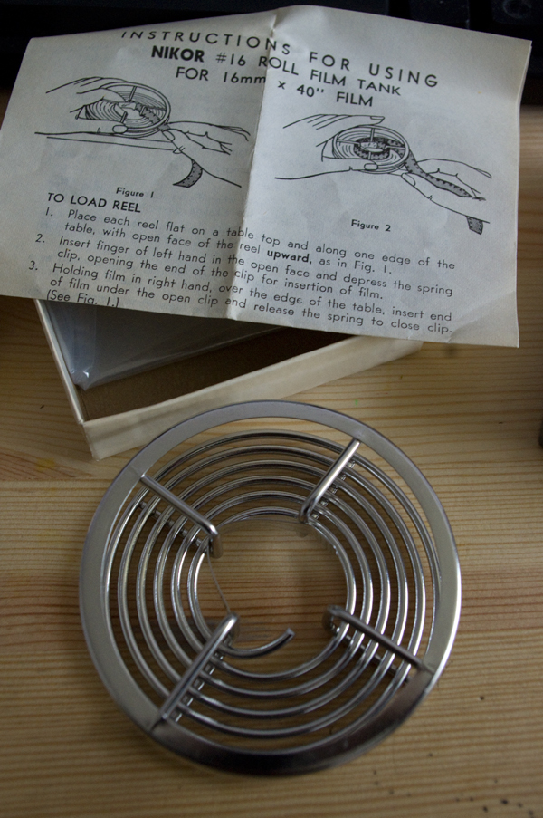

Indeed. Things like this work just fine! I used PVC pipe, not an instant OJ can. Now, I have some reels, thanks to A.P.U.G. I have 8 of them, brand new in the original boxes, and I paid $13 a piece, just so you know what sort of expenditure you are looking at.
