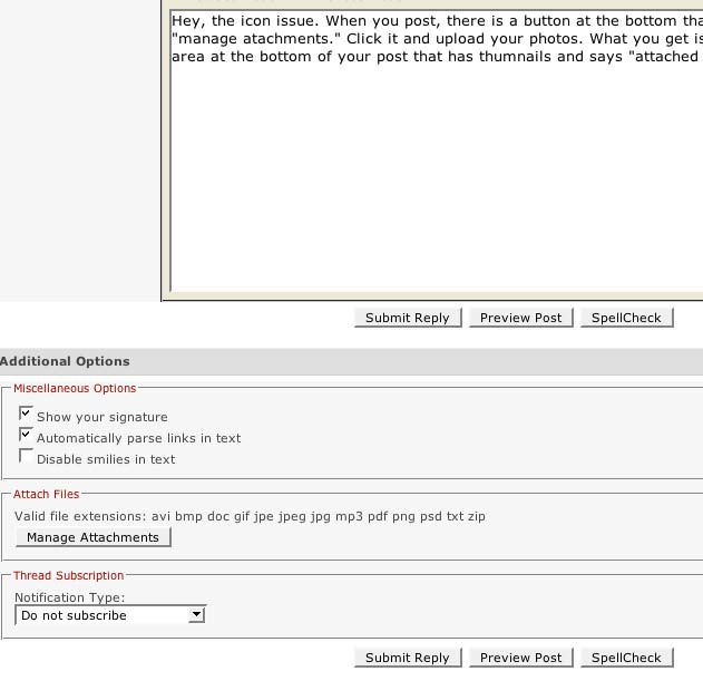

Hey, the icon issue. When you post, there is a button at the bottom that says "manage atachments." Click it and upload your photos. What you get is a little area at the bottom of your post that has thumnails and says "attached files."
I have done it so you can see what I am talking about. The attachment is a screen shot of this form.
