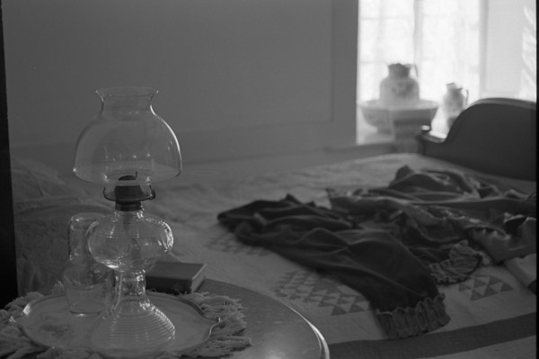

Well they came out! Thanks for the help. I did the D76 1+3 for 7 min. I forgot to comp for the temp, solution was at 74 deg's but it worked ok.
Here are a couple
The small adjustments I can straighten out in printing.
If I ever do that again at least I will not worry as much and sort of know how to fix it. Thanks again
