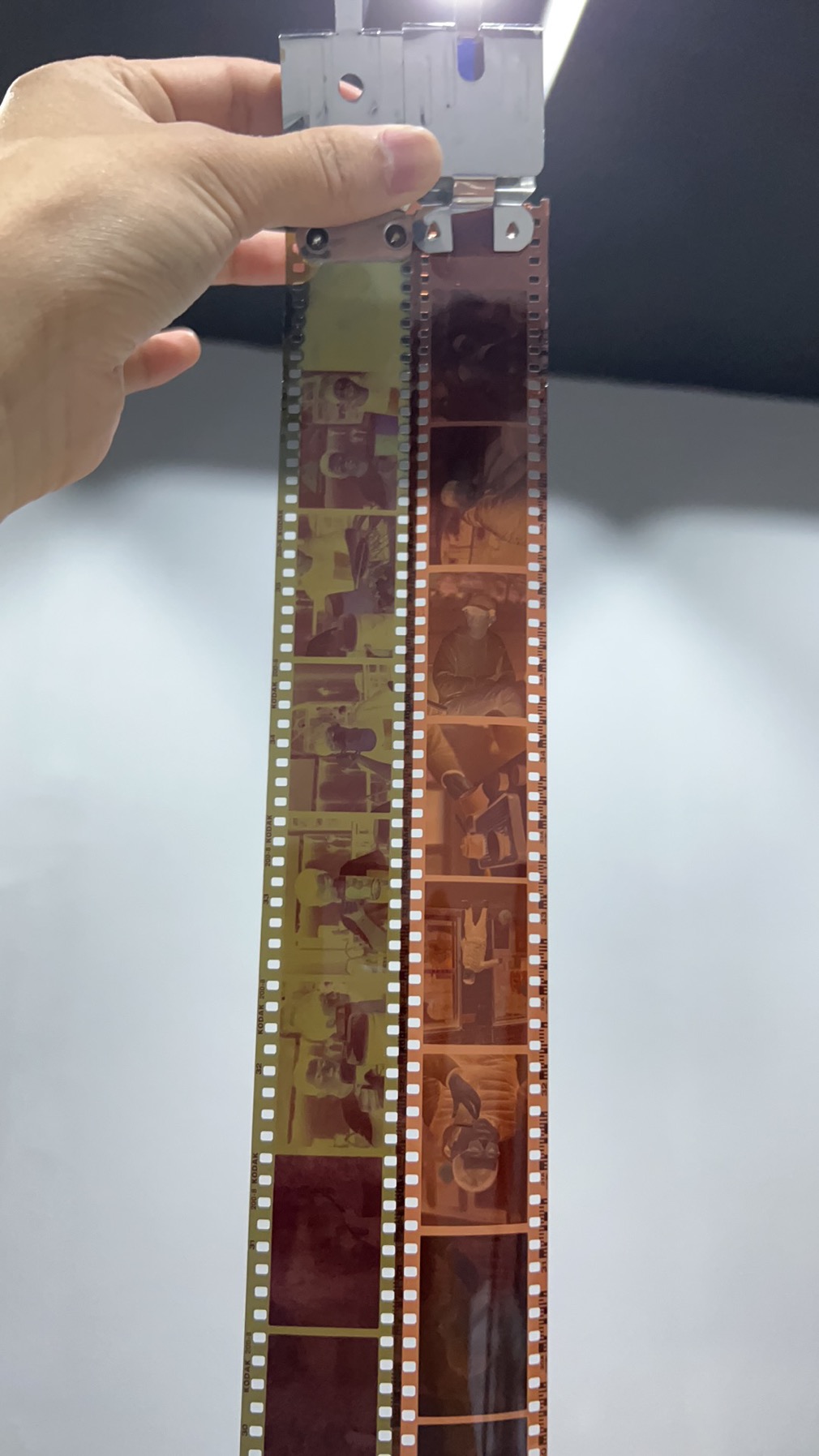

I processed two rolls of color film (they all color plus 200),one after another. same chemicals and same temperature, in my Jobo,but the film base color is different. The one on the right looks good, but the one on the left looks off in comparison. Any one has any ideas what cause this to happen? Thanks!

I've had colour film that was exposed to too much heat (in a car for a while) be that colour when developed.

Couplers have have coupled in areas not to have been exposed.
Think of fogging of film in the most broad meaning.
