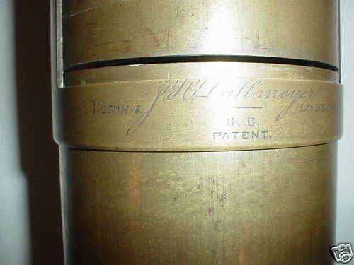

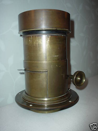

The downturn in the world's economy seems to have had no effect on the soaring prices of petzval lenses. I was thinking of bidding on that Dallmeyer 3B, but didn't want to pay the $900 or $1000 I thought it would sell for. The 3B is pretty rare as far as ebay goes, plus it was in good condition with a flange and waterhouse stop. As crazy as that sale was, there's still some justification based on the rarity of the lens. One auction that competely baffled me was this one-- http://cgi.ebay.com/ws/eBayISAPI.dll?ViewItem&ssPageName=STRK:MEWAX:IT&item=290274192559
Yes, that's over $500 for a nameless magic lantern lens. Maybe it was the pretty photos and rambling, but uninformed text.

Any good reason for this high price?
Stupidity, greed and vanity: the usual prime movers for most human behavior.

allmost 1900$!!
>snip<
:rolleyes:
I was on a Weekend meeting on a Highschool here in Denmark this fall. The teacher there really praised those Dallmeyers and Dagors. He said something about lensnames starting with a D. So offcource now we all want one. If I had only set my ending bid 100$ higher :rolleyes: :D
