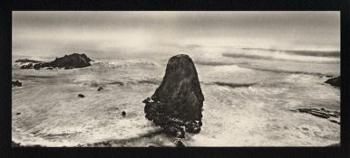

Thanks for the plug, Ron! and thank you for the interest, Tim.
Yes, today it is possible to produce a graded paper with just about any characteristic you want starting from any number of watercolor papers. You can choose texture, base color, and emulsion color and then further influence them through developer choice and toning.
In addition, negative emulsions are coming right along - either dry plate or the subbed film that the Formulary will hopefully start stocking again.
And, my current favorite application - Silvergum (gum over emulsion).
Here are a few examples: 'Yaquina Bowl Storm': emulsion over Fabriano Artistico HP watercolor paper, 'Snow Dusting' on the commercial baryta paper sold by Photographers Formulary, 'Pancho & Herman': 5x7 dry plate (glass negative) enlarged and printed on Ilford Multigrade, and a crop of the same, and 'Aquarium Village Pirate': 5-color gum ('Silvergum')
And there's more:smile:
http://www.thelightfarm.com/Map/ContactPaperDev/SilverGallery/EmulsionThumbs.htm

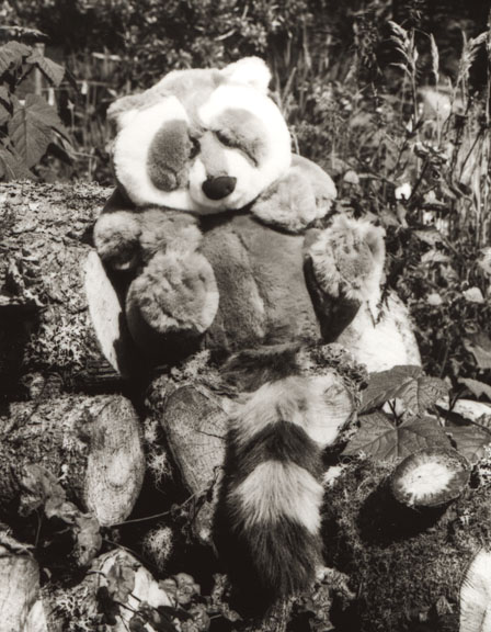

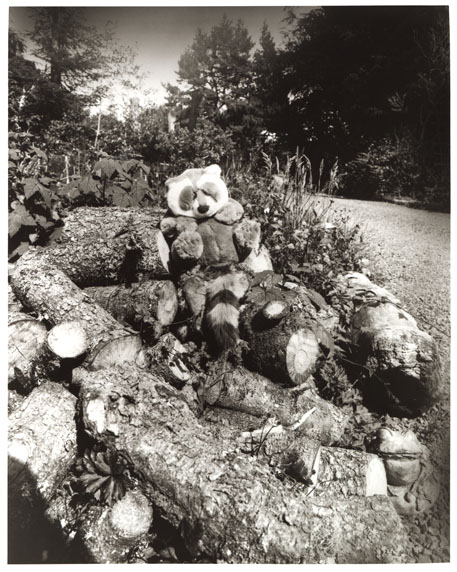

Any print examples from contemporary dry plate negs?
Eric, Arigram, and Sandy: Thank you very much for the nice words. I'm a big fan of your work, Sandy, both your photography and your writing.
Dave: I don't know if you saw the dry plate example I posted in the blizzard of jpegs in my last post. 'Pancho & Herman' is a 5x7in dry plate (made last week). I stuck the plate in the 5x7 film carrier of my Zone VI enlarger and printed the plate on Ilford Multigrade. The file from scanning that print isn't altered in any way.
"The exposure was made late in the afternoon on a sunny day. Wisner 5x7 field camera, 90mm lens, f/16, 3 sec. Developed N-1." This is my description of the plate that made 'Pancho..'. I think it is far more useful than a ASA/ISO number, which is as much a quantitative sound bite as a meaningful descriptor of the materials.
I am finding, without even consciously deciding to, that I am thinking in the terms of a plate maker - my thought process falling in line with the potential/constraints of the old emulsions. When I got started with this I had the idea to 'time travel', if you will, starting from the beginning of the craft and moving forward without any preconceived ideas or expectations, rather than trying to recreate something contemporary and commercial. After all, my heroes at Ilford have the present well covered.
Below is another example of why I think a more comprehensive and qualitative approach is needed: "Puff Amidst the Posies" and two crops. (Enlarged and printed on Ilford Multigrade) Puff is dark purple with a light green belly. The lilies to his left are lemon yellow, and the ones to the right are cream white. To a spot meter the purple is darker than the green and the yellow and white lilies have almost identical values. But, because the plate emulsion is orthochromatic, the values don't register like we would expect them to with panchromatic film. You have to add another level onto your pre-visualization.
It's all very different from modern film and fascinating and far, far easier than you might imagine. I hope more people give it a try.
