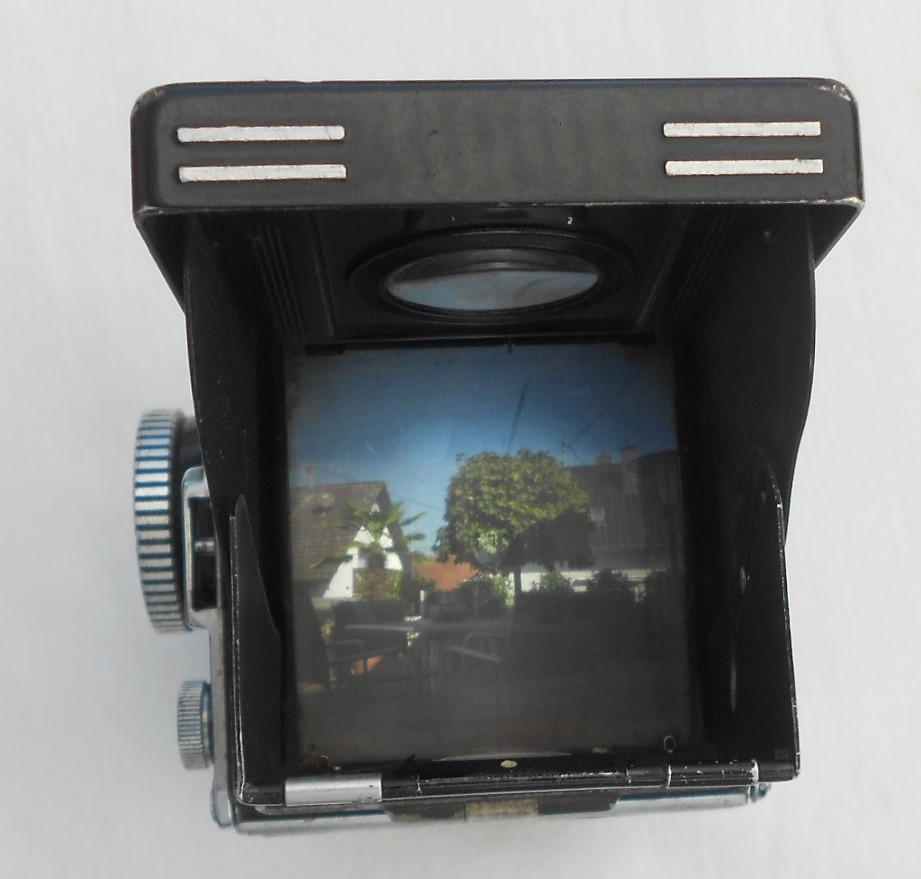

A standard description from a seller who may not know much about camera and recommend to keep it in Vitrine.

Tons of wear. Look at paint around wind lever panel- all gone. Focus hood is coming forward slightly more than it should. Lots of tarnish on filter bayonets. Appears to be oil or tarnish around blades of shutter. Aluminum rim on back door has dents, wear and oxidation. That camera has been USED. Which is great, nice to see that it has had a good life.
I'd pay $100, maybe a bit more with better detailed photos of the taking lens. It's mainly either working already and then worthwhile as a knapsack shooter, or it's a parts camera at best, not worth risking the overhaul to get working.
All in all I don't find that well-worn Rolleis develop the same attractive patina of, say, a black paint Leica. Maybe if Rolleis had brass instead of aluminum coming through?

What Dan said. Very worn and without a detailed description on functionality from the seller— who knows, a boat anchor or great user? With any undamaged old Rollei unless there is a receipt for a recent CLA from a reputable repairer you can probably figure you are going to need about $300 for a CLA so figure that in to the purchase price.

It doesn't look that it has been stored in a good climate either, which isn't a good sign. For the price of a CLA, or even cheaper, you could get a working Rolleiflex with Tessar in very good condition.

I was tempted but NO. Had those gears would have oxidized like the case then its only depressing to own it or CLA would cost 3-4 times the camera. Waiting for good one pref., with a Xenotar and without a lightmeter and a 3.5
This offer is buy it now for €155

Looking at the photos it looks like the body was either stored in the case and or an old camera bag that got damp. The bayonet mounts look oxidized,
the rest of the body looks like it has been exposed to damp as well. Probably has a distinct mildew smell and would need and extensive CLA. I would stay clear of it.
