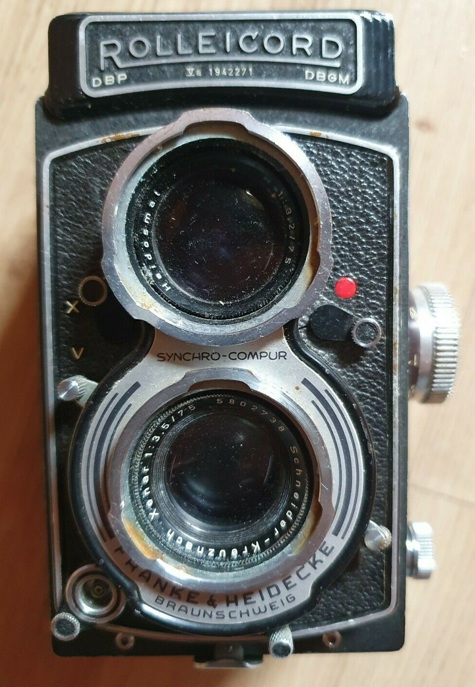

Would you buy this?

With no other information but that photo? No!
What is the point of asking that? It should be obvious that without information about pricing and return privileges etc. nobody in their right mind would buy any camera.

For €18 yes... But I think it will need quite some money before it's ready to use.

For complete CLA it may cost ~15x the current bidding amount.

It depends. After a good dusting and a (gentle) wash, it may surprise its new owner.
The OP has not given us much information to go by. It is a buy it now, and if so for how much? What is the starting bid, 99 cents or $300? Was there any text along with the image? Details, please.
Rolleicords are built like Panzer tanks. A Vb I bought for A$95 some years ago looked equally bad. I found it was generally quite okay, and after I had spent a bit of time cleaning the body and removing the rust (like on mine, the rust on this baby looks to be only on the surface anyway), I put it thru its paces and found everything on it was working. Both lenses were clear (those on the above image seem quite unblemished as well, beneath the dust and grime) and surprisingly all the shutter speeds worked even tho it had been in a bag for 10+ years.
So yes, maybe. It would depend on the price. Start at $25 and see what happens.
However, it is true that a good CLA will cost several fortunes more than I would expect to pay for the camera. So LTBB...

The picture has a lot of detail but also a lot of dust and a few stains. (Inside the lower filter bayonet) If the shutter speeds were OK and the crap on the lenses was only surface dirt I may consider it. I would also like a look inside the body and at the focussing screen as well.

I have requested few more photos inside and as well as the focusing screen. Yet to get a reply...

Yes I'd buy it at that price, but only if I knew how to CLA it myself because it looks like its gonna need it. With no returns, I'd want to be sure I wasn't throwing away more than 25 bucks on a possibly unfixable project.

Honestly, I look at that camera, and think it's been neglected. It's been exposed to moisture, it's scuffed-- not that these are necessarily terrible, but anytime someone says "I don't know how to test it", I assume the worst, and the lack of pictures of the focusing screen bothers me.
And a pet peeve, it wouldn't take that much to blow/brush some grunge off the lenses.

With respect to OP's question, eBay auctions always increase a lot in value in the last hours and minutes. I would buy it for $20, but it's probably going to sell for closer to $75. I don't know if I would buy it for that price.

I expect the price to shoot all the way up to €100 or more than that.

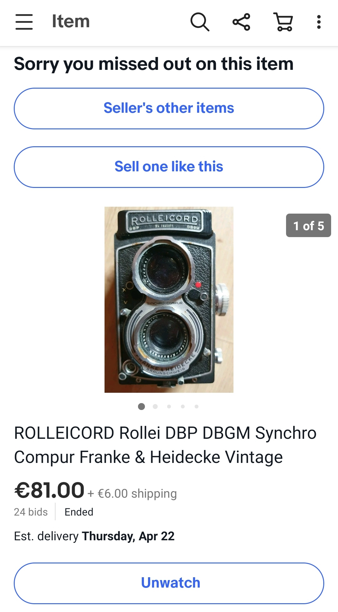

There are many brave heads there...
baachitraka
baachitraka
Apr 6, 2011
3,620
Bremen, Germany.
That said, "Sorry you missed out on this item"

The camera is worth about A$100 (in Aussie dollars) for parts alone. Bits and pieces are often sought after by home repairers and even camera repair shops have one or two old bodies which they cannibalise for parts. The camera back, the ground glass and mirror would be two items a canny buyer could resell quickly on Ebay.
There are times when one has to think laterally. But I do agree, paying more than say $75 for this beast would be a risk.
