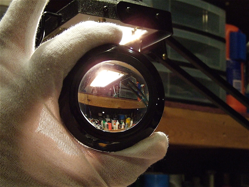

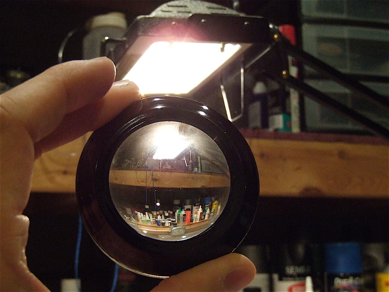

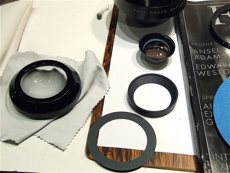

Before and after cleaning a Fujinon 125mm SuperWide bargain lens.
