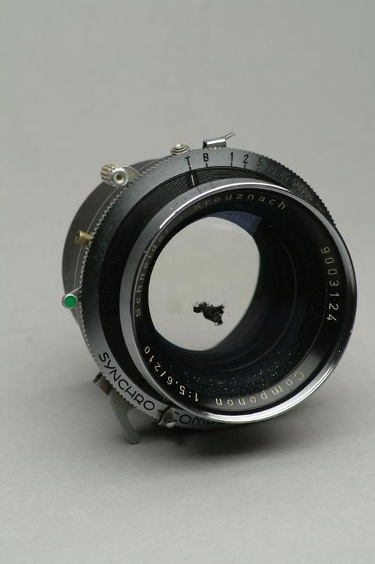

so, Brian, I guess that this lens would be total trash???
Of course, it could be perfectly fine:
(and on 8x10 film no less....)

In the words of a well known large format lens purveyor, lens defects generally affect the user more than the lens. As Erie's example showed, obvious defects can be invisible in the final print.
Two of my lenses have 3-4mm scratches near the center of the rear element with no apparent effect, except on the price. Hence I picked up a 240mm Sironar-S ($2300 new) that was in perfect condition except for the scratch for $500.
I also have a 19" Red Dot Artar with significant cleaning marks on the front element that I picked up quite cheap. It looks like someone cleaned the glass with steel wool. I haven't done a direct comparison to a another lens, but it seems fine. If contrast is reduced, I haven't noticed. Unscientific to be sure (maybe I just have learned to develop longer), but it illustrates the point. Beyond that, common sense prevails. As mentioned previously, the price should reflect the defect, and a good return policy is your friend.
Check out the image quality this damaged lens can produce.

epatsellis, does it work that well stopped down? If so, I'm impressed. Again, I use to be of the 'lens defects are less of a big deal than people think' camp until picking up a few lenses with a bunch of cleaning marks which had extremely poor contrast to the point of being usable for the shots I wanted to get.
The impact on the negatives changes defect to defect. Without the ability to test it and be sure I understand what impact there is if any, I personally wouldn't be comfortable putting down a bunch of money on something blind unless I was confident I could sell it for the same price if it didn't work for me.
