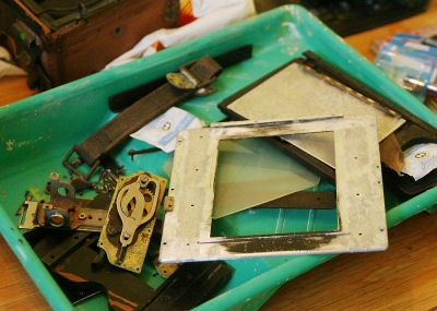

I have accumulated a stock of broken cameras, lenses and motor drives/winders that I use for my personal repair training. It's not that easy to get such devices here in Europe, and if you do, they're quite expensive.
Everything is stored in lockable plastic bags and cardboard boxes.
I'm not worried about hygiene or insects, it's always cleaned anyway as soon as on the workbench.

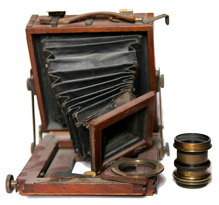

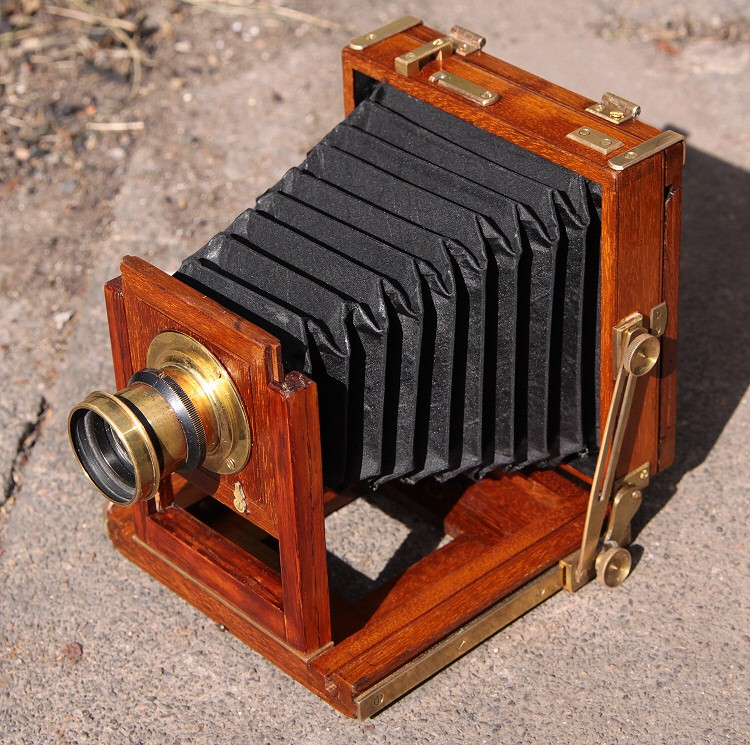

I started around 17 years ago, I'd moved abroad but still had my house in the U. On a trip home I was having a clear-out and decided to put this sorry looking camera in the trash. I'd been given it some years earlier by an ex-girlfriend.
Then I thought what a waste, and decided to restore it. 3 days later and it was nearly finished, just needed some brass parts, and a new carrying strap..

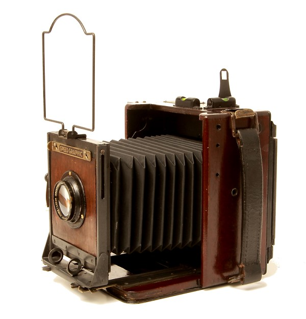

Next, I had a Crown Graphic but decided I needed a Speed Graphic for use with my brass lenses, so bought 2 from the US, listed on eBay as parts cameras with enough parts to rebuild one. However one was a ore-Anniversary, the other a Pacemaker missing it's shutter.

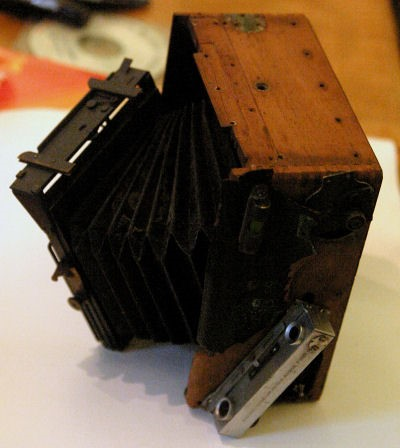

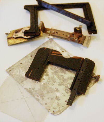

The Pacemaker had damaged inner rails, the ore-Anniversary looked terrible, falling to bits, so I stripped it down.
It was apparent it had been modified when new to be a WA camera, the rangefinder is set for a lens of approx90mm, and the top cut away to allow front rise. It was another quick restoration, just a few days, I serviced the shutter, patched the bellows. Later I found I had better bellows so replaced them.
That was the start, I've restore many cameras since then.
