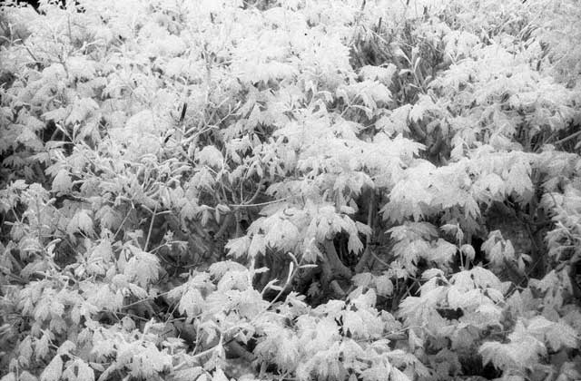

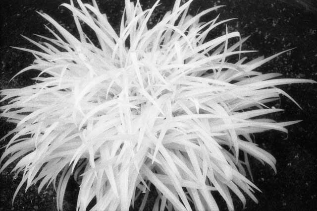

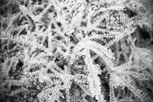

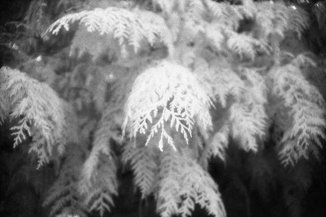

+1! You don't know until you try it out. Personally, by and large, I've found film has a tendency to stay good. I have Tri-X expired in the late 1980's, and frozen, that's still quite decent. And I just developed a roll of HIE that I hadn't kept frozen, and it turned out decent. Yes, there's some base fog, but it prints through just fine. The HIE roll had been in the back of the fridge for many years, and then it sat outside of the fridge for a while. I have a brick of it frozen, so I'll see how that turns out. I can also try some Orthazite with it.
