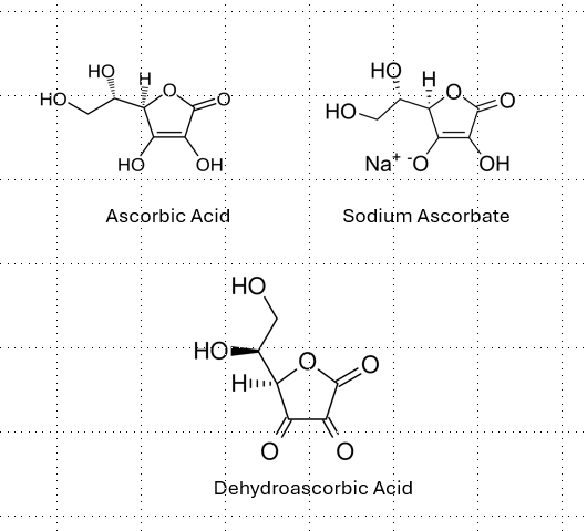

I am a (retired) chemist... 😉
for this application [i.e. the conversion Cr(VI) to Cr(III)] either ascorbic acid or its sodium salt will work just fine. The salt is more soluble in water and a bit more reactive that the acid form but I doubt that the differences make a difference in this application.
Either form will be oxidized by the Cr(VI) converting the metal to CR(III) and the organic compound to dehydroascorbic acid.
Structures below for those who are interested.
Thank you, fgorga!
The structures look similar with exception of the missing bottom "H" where the sodium is. I would like to learn more about chemistry.
This is great!
fgorga
Aug 31, 2015
843
New Hampshire
Thank you, fgorga!
This is great!
Bob,
You are quite welcome.
With regard to learning more chemistry and noting your location, I venture to say that there are a number of institutions of higher learning in your neck of the woods that offer 'general chemistry' courses and which, I am quite sure, would let you enroll for a 'small' fee!!!! 🤣
