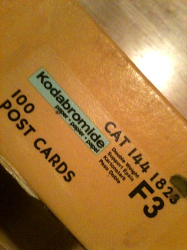

I inherited this from someone who went digital who inherited it from someone who went digital, etc...
It's curvy but still usable. I'd sure like to be able to say how old it is.
Would anyone know?

According to (there was a url link here which no longer exists):

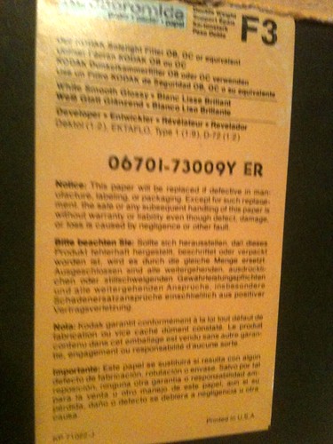

Although I can't directly tell the date of manufacture, the date of expiration would seem to be September of 2004, 1996. 1988, 1980, 1972, 1964, 1956, 1948, etc.
Are there any online references to pin this down? It would be helpful to know when Kodabromide was discontinued, or better yet, the date range of manufacture.

Kodabromide was discontinued in 1999. As for when it was introduced, it is not in a 1937 list of Kodak papers but is listed in 1940.

It was called Kodak Bromide in the 20's & 30's, and in the UK up until at least the 70's, I think that's quite late production looking at the packaging style, typefaces etc, 1990's
I had some 50's/60's Kodak Bromide and it was still very usable, it keeps longer than warmer tone papers.
