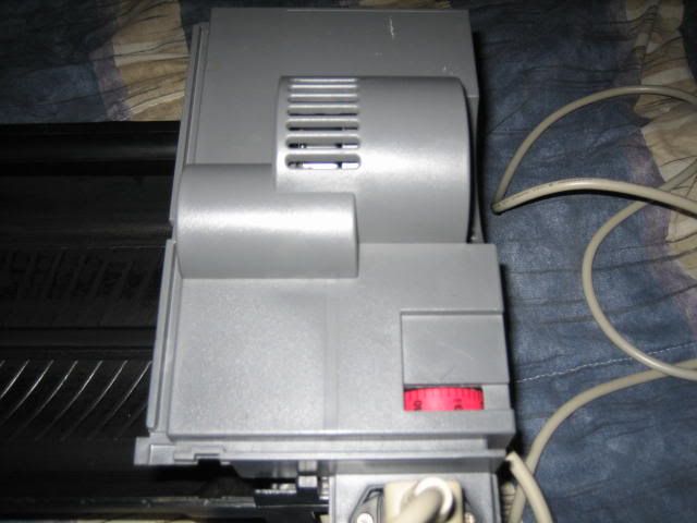

Here is what i have to work with, I removed the lid and the roller unit. I wonder what circulated the water in the processor... the rollers? I would be happy if i can use it for one roll at a time since i rarely shoot color.
