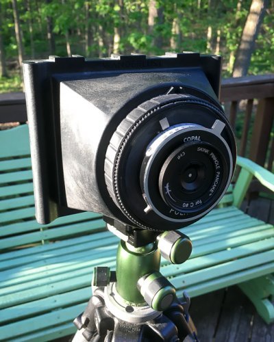

I'll be using my 4x5 Travelwide camera with a Skink pinhole mounted in a recycled Copal shutter from a Polaroid process camera.
