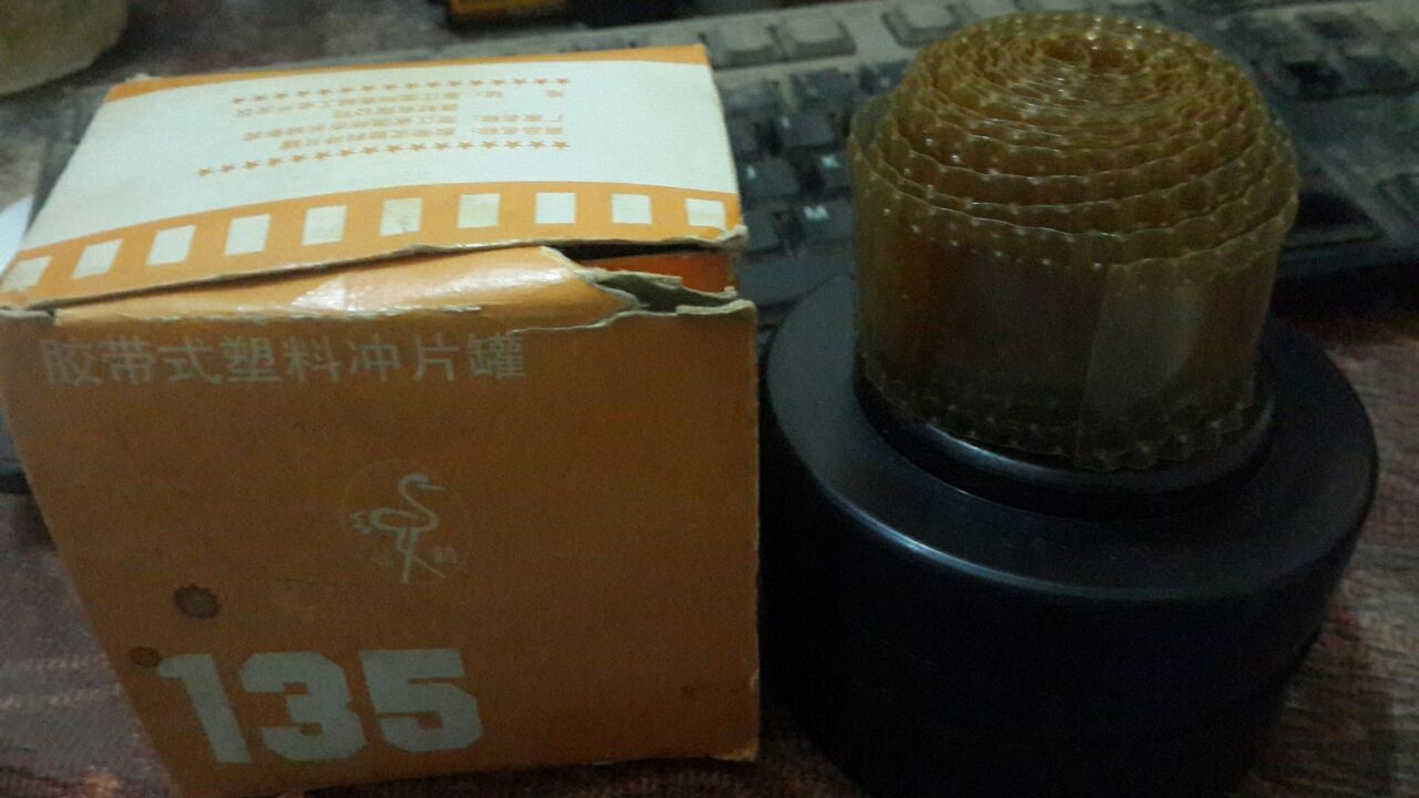

This is the solution I resorted to in such cases.
- Chinese development tank Happy Swan brand,,
It is said that it is basically an imitation of the Russian tank brand (The Graceful Swan). Maybe it's a joke, I don't know.
In general, whatever the case,
Summary of the case,, This tank does not have a reel.
I consider this tank a genius design because it solves a major problem with that strong flexible plastic tape at the same time, and it forces the film to bend along the principle of a zonborock (almost) while allowing all liquids to surround the emulsion on all sides.
This tank allows the development of a film measuring 110 mm, or even a microfilm or any size smaller than 35 mm
And I was so grateful for this tank when I used it with a roll that had its sides destroyed and torn off using a Russian Zenit camera,
This is a cheap tank, one of the Egyptian merchants brought it through the Alibaba website at a very cheap price and sold a lot of it in Egypt..

That certainly looks like an interesting developing tank. Do you know where to get one? There doesn't seem to be any mention of it anywhere else on the internet and I can't even find a photo of it apart from yours. I've checked both Alibaba and Aliexpress and I only see the Paterson-style tanks for sale. Its interesting since there doesn't seem to be any documentation of it existing anywhere, but it looks like a really cool and unique design.
I do not have any other information, I do not have any documentation about the site that was selling that tank, and I am not the one who bought it from the Internet, someone in Egypt bought it for a small amount (maybe he bought five pieces) and brought them to Egypt and sold them, and I bought from One of the people who bought that tank.
What I only know is that it is a Chinese tank and it was bought online, I do not have any other information, and I do not know the name of the site from which it was purchased.
You should try hard and search the Chinese & Russian sites,
They are known as Correx or apron reels. They work OKish if properly used. I've had film get stuck to the apron and developing unevenly or fragments of the apron that fell off and messed with the film. NOS is still available in Bulgaria/Eastern Bloc and is how I processed my first few films in middle school. I think their most relevant application nowadays is processing paper base films (Washi).
I think our colleague ((( OP))) would be very grateful to you if you could help him to buy a tank of this category.
