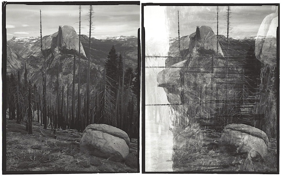

Are these locks important?
I mean, a slide won't come out by itself. If erroneously pulled, that would be when already inserted into the camera. To me it seems much more important to get unexposed vs.exposed right.?...
Stuff happens:
