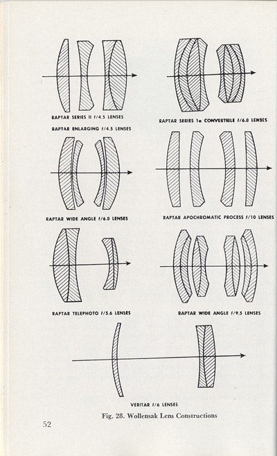

The lens that I ordered is a BGN 6.8 version according to keh, there was no picture only labeled "108 f6.8 raptar wide angle, rapax bulb, time (4x5) (35 mount)"
Looking at Desertrat's link, the lens seems to be a 4 element 2 group double gauss type?

Outwest, I believe, could be mistaken, that in the optical engineer dialect of English a lens element is a single piece of glass. A group is one or more elements (if more than one, all cemented into one piece with no internal air spaces) with air on both sides. Lenses are sometimes mounted up in barrel or in shutter with one or more groups on one (or both) sides of a diaphragm. When the groups on one side of the diaphragm are mounted so that they can be removed as a unit -- this isn't the case for all lenses, when my friend Charlie Barringer unscrewed what he thought was a 55/5.6 Lamegon's rear cell from its shutter, the groups fell out -- the unit is called a cell.
A four element double Gauss type's lenses are laid out this way: ((|)) where ( is a single element and | is the diaphragm.
