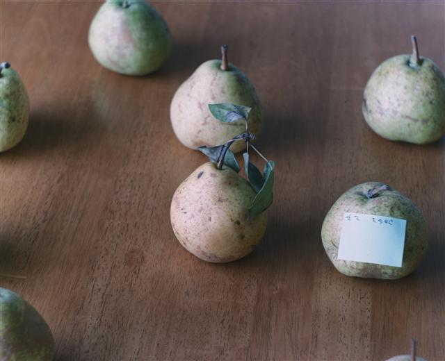

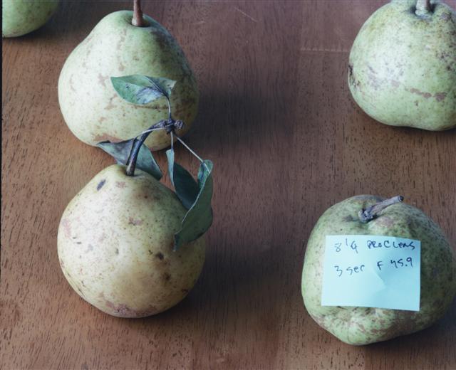

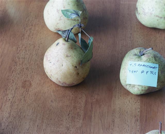

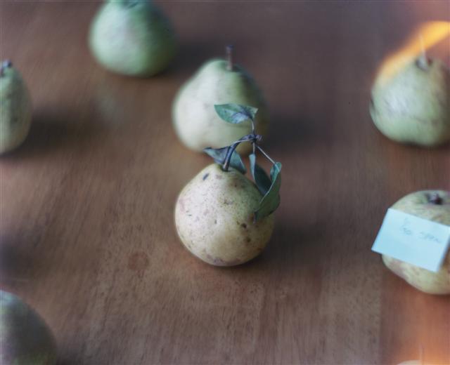

Oct 25, 2004
1,057
Westport, MA
I've attached some results.. These were taken with a 4x5 speed graphic.
I used graflex rh10 6x7 back, developed them at the lab and scanned them in using the noritsu film scanner.. Sorry if i've hijacked this thread :sad:
Oct 25, 2004
1,057
Westport, MA
The first one is the petzval with no stop.
Second one is with the f8 (roughly) stop.
Third is the 7.5" uncoated Kodak Anastigmat (nice lens!)
Fourth is the Aero Ektar wide open.
Fifth is a jml process lens (astro-goodkin)..
