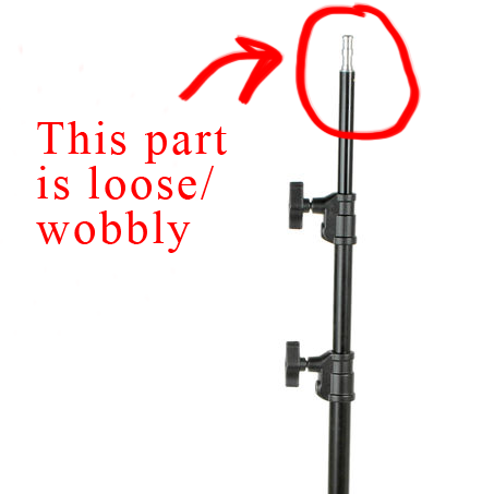

I bought a couple Avenger 'Baby' light stands (the cheaper, more portable aluminum stands. NOT C-stands). I got a good deal on them, because both of their mounting studs are wobbly.
Anyone know a good way to fix this?
I though I could simply pinch the metal tight with a large vice grip, but it didn't work. And I've seen people gaffer/duck-tape them all to hell, but that didn't work too well either.
I don't think the stud would fall off easily, but it's unnerving mounting heavy lights and watching them wobble like a bobble-head. Otherwise, the legs are solid.

I've had great success bonding metal parts with JB Weld.
Epoxy sounds like a good idea, but I would supplement epoxy with a strong metal-to-metal connection.
Looking at my Avenger stands, the spud to tube connection is secured with a pin. If that’s the case with your stands, you may need to re-drill the hole to accept a larger pin. Or drill another hole at a 90-degree angle to the original or a similar pin.
If a pin was never installed, consider drilling and installing one.
Yeah, mine are held on with a pin or rivet or whatever. That's what's wobbly: the 'pin' holds the stud to the tube, but the tube isn't tight around the stud. So, it wobbles and the 'pin' is the pivot-point.
Here's a "you might get lucky" option... since this is sort of a press fit with a rivet, see if a pex band will slide on there.
Pex is a flexible plumbing product, with plastic tube and fittings which are joined with copper bands that you compress with a circular tool. You could probably just walk into a big box or tool rental place and compress the band.
Other than that... drill out the rivet, pull the pin, roughen the surface of the pin and the inner wall of the tube with coarse sandpaper, JB Weld (stronger than epoxy with steel - epoxy is brittle and would likely loosen over time), force the pin back in (the JB is thick stuff and will probably make it hard to get the pin back in, which is good) and have a machine shop properly install a new pin or taper pin - they'll ID what needs to go in there, it may just be a really butch rivet. Or just take them to a small machine shop and ask for a quote.

I'd rather go the DIY route. And I don't have any metal working know-how.
BUT, I know a guy that does automotive restoration, building hotrods/ratrods. I could ask him to help me with it the next time I see him. He knows his stuff, and has a pretty well equipped shop, likely with the right kind of welder. But I wonder if there's extra difficulty welding steel to aluminum. There's not a lot of room to build up a weld where it wouldn't cover too much of the metal stud or burn through the thin aluminum tube.
The one time I had an aluminum stand repaired I learned welding aluminum is much more involved than steel. If it were me I'd push the pin out and apply Dead Link Removed and reapply the pin if possible, but after curing it'll likely be fine without. Done well this will support as much as the stand will hold and it's a relatively quick DIY so you can move on to the next item on your list.
I'd go with Rick A & Dan Quan's JB Weld.
It has more body & is less prone to running than common epoxy. Another option is liquid steel.
I suggest you clean the parts with acetone prior to epoxy repair, it'll work better, and clean up afterwards with it as well.
I've fixed dozens of these crap Avenger stands before getting rid of them all. Get a 1/2 inch copper pipe cutter...it's the kind you cut by doing laps of the tube, tightening
a little each turn. Pop the rivet (or roll pin) out of the top which holds the fitting in the tube. Cut the tube below the original. Drill a new hole to the next larger roll pin size.
Re-install new roll pin...you can also use a construction adhesive such as Liquid Nails (comes in a tube like cauling) when installing the fitting in the tube too for extra security.
Then, list on Craigslist and go out and buy an American (that's the brand) BBTR. (baby-beefy triple riser)...often, grip places sell off old gear.

Here's a ghetto fix. If the aluminum part is inserted into the stand, you can go to the hardware or auto parts store and get a hose clamp that a little bigger the the shaft and cinch it down. You can put some black electrical tape to cover the repair to make it less ghetto
Drill out the pin, remove the stud and then epoxy it back into place. It should be rock solid.
To CropDuster's point, KEH.com sells used Manfrotto stands for next to nothing and the build quality is tremendous. I bought all of mine used and they've worked flawlessly.
First you can weld steel to aluminum, having said that it is the exotic process and you are not going to be doing this at any normal shop. Also the aluminum will be soft from the weld in what is known as the heat affected zone. So do not go there. The cost of this process will be high. New stands are far less expensive.
The simple and in the real world the most effective fix is the pull pin, clean area and then the JB weld. You will be good till something else lets go.
Arthur
This isn’t a high dollar item, so let’s not go overboard on the repair. First, it can not be welded by commonly available methods. Even if it could—aluminum to aluminum—it would cost way too much.
Just remove the pin, pull and clean the spud, mix up some JB Weld, coat the spud and reinstall everything.
Then get rid of the aluminum stands and follow CropDusterMan’s suggestion and get higher quality steel stands. I've been down this same road, and I ended up getting rid of my aluminum stands. Steel stands weight slightly more, but if you drop one, or it falls over, they don’t bend and dent as bad.
Is there room to drill through at 90 degrees to the existing 'rivet' hole and put a small bolt through ? Is the top of the alloy tube pressed/squeezed into a groove around the 5/8ths adapter - if so, perhaps that can be tightened up as a temporary fix using a nail punch or similar.
