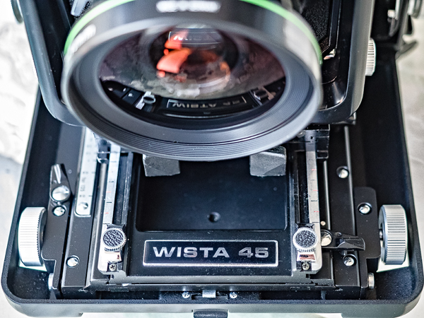

Yes you need to have the focus rail all the way back otherwise the front standard will drop off into nowhere. But it shouldn't take more than a minute to get it back on track either. I don't think I even need to lock the focus rail on mine, maybe yours is loose or mine is more snug.
The right side lever locks the lower rail. The 2 left side levers lock the upper rail, the one the front standard slides into (or should). Both or just the rear left one can be used when the upper rail is retracted, and when the upper rail is fully extended only the forward one is used.
When you pull out the front standard make sure all parts of the rails are flush with each other in front. They should be about 1/4 inch back of the front edge of the bed. This is also where you want them for closing the camera. There should now only be 1/2 inch between the rear of the upper focusing rail and the stationary rail the front standard sits in when retracted. If your front end still slides off instead of sliding into the upper rail, something is wrong.

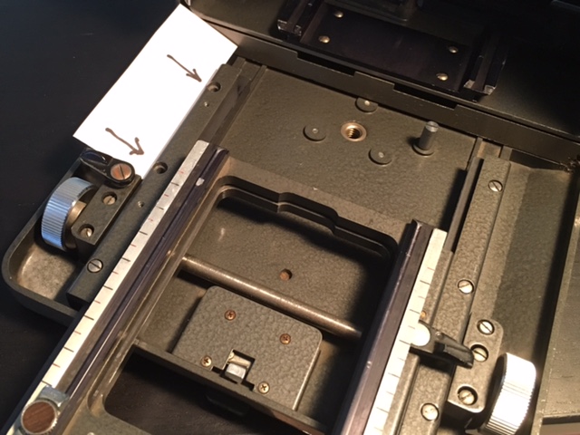

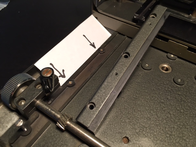

Thanks for the pictures. Upon seeing them I remembered repairing some broken off screws in the left side (of the picture) rail guide. The info is on the other computer so I'll check it tomorrow for details of the rail locks.
Rail locks work in one of two ways, the shaft the lock lever is on is pushed down against a brass or bronze pad which applies pressure to the focus shaft making it difficult to turn. This type usually has to have the rails removed from the body and the lever starts in one of three positions.
The other type presses a pad in a similar manner but puts pressure on the edge of the rail.
Either type should be loose enough for the rails to move with the lever forward toward the front of the camera and tight to prevent movement when pulled toward the rear or pressed toward the rails.

The rail guides have to be parallel and aligned with the body fixed rail. Loosening the guide screws is necessary to remove the rail assembly. The base of the rail has an angled gear on it that stops or has a pin that prevents further turning of the focus shaft. With the rail fully extended, guide screws loosened 1 1/2 to 2 turns the rail should pull out the front of the bed. Installation is the reverse ensuring that the rail starts on the same gear on each side then the guides are aligned with no side play in the rail and the screws tightened. Aligning the guides is the hardest part.
