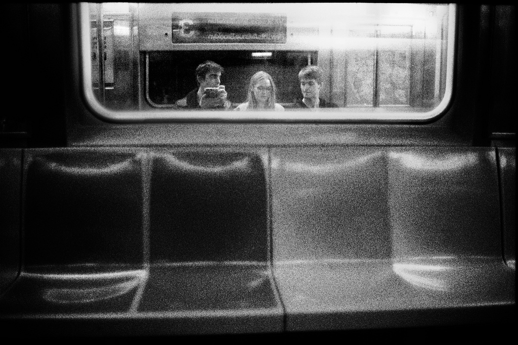

Back in the 90s I shot a lot of rock bands with Kodak Recording film pushed to something silly in DK50... they had a similar 'gritty' feel.
The nice thing is that D3200 is also extremely sharp when you want it to be. I shoot a lot of it, and even through the grain, the prints are extraordinarily detailed. I've been able to resolve the thread pattern in dress shirts under the grain of D3200, processed this same way. That example was shot at a lower speed on a moving subway though, so shake destroyed a lot of the subtle detail.
Yes, I get the impression it is faster and much finer grained than Kodak Recording film - but then that is what you expect comparing a delta grain emulsion to an old 'conventional' film.
The trick is getting these really good ultra modern films to to behave like older emulsions when we want them to. I'm sure there is a lot moe scope for experimentation, here...

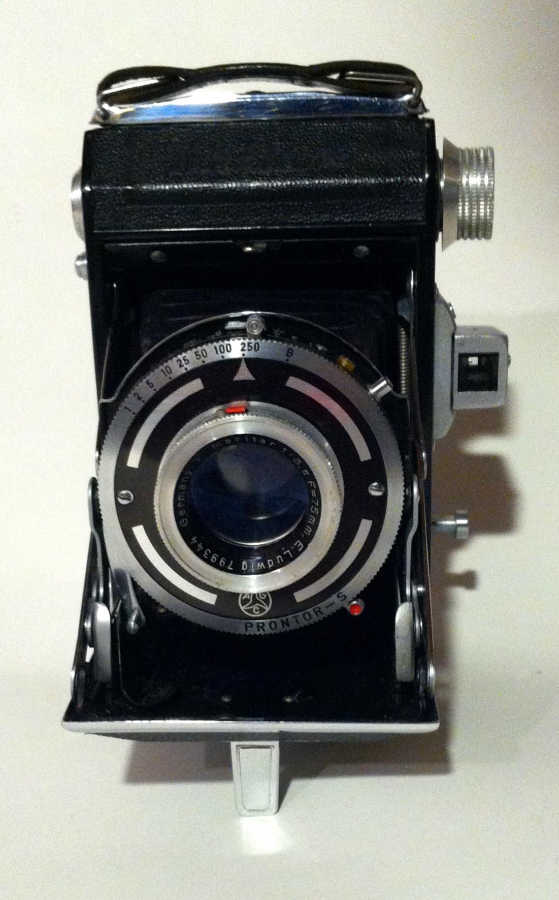

mark
this was taken with tmax 100 ( 4x5 film )
about a year ago with a box camera ...
the developer is a mixture of coffee, washing soda, vit c and a small amount of ansco130 print developer
i didn't agitate it for 30 mins ...
if it was enlarged it would be as grainy as a 35mm frame
but it is not large or magnified ...
