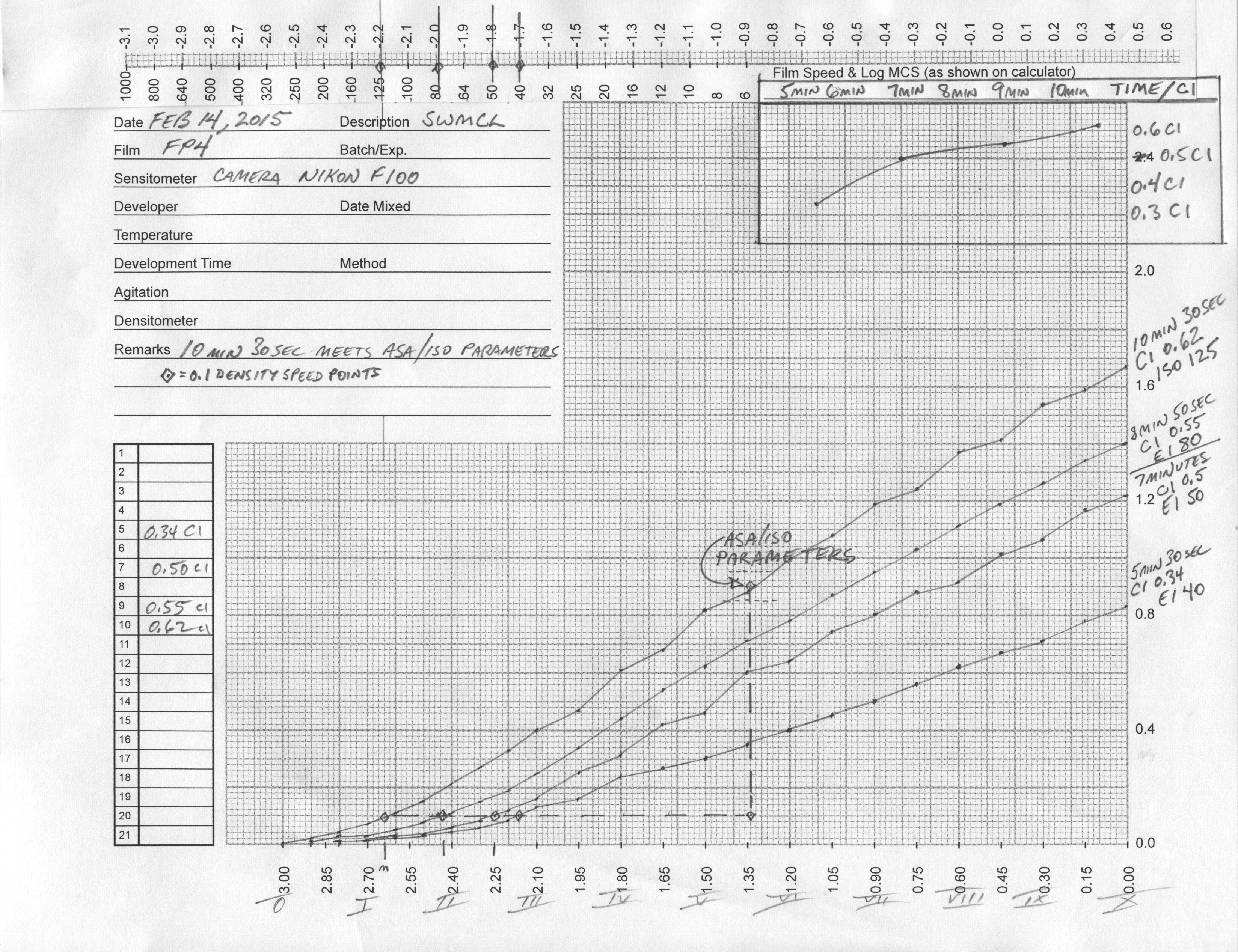

Here is a full amount of data. Just refer to the shaded parts. If the ISO values come out wrong then shift the whole block of shaded data up or down until the ISO values are reasonable. Just in case you're wondering, the actual shoot data is from Zones 0 through 15 as shown on the leftmost area. This includes actual shoot data in third stops from zone 0 through zone 3. The interpolated results are in the centre section from zones 0 through 15 in half stops. I've fictiously added some values to Zone -2 above the dataset and some value to Zone 18 below the dataset to make for easier polynomial generation in a program called qtiplot.
The actual shoot is a roll of FP4 on a Nikon F100.
  • Final values entered into Winplotter for FP4 in 1:200 510 Pyro.pdf

Great set of data, I am using your 1/3 stop and 1/2 stop data and subtracting the Zone 0 as if it is B+F
I assume the film is fresh and your developer is intended to give full film speed of 125, (If not, let me know what speed the developer is intended to produce with this film).
Bill Burk
Feb 9, 2010
9,316
Here are the results on paper:
Time: 10 min 30 sec
CI: 0.62
*EI: 125
Time: 8 min 50 sec
CI: 0.55
EI: 80
Time: 7 minutes
CI: 0.50
**EI: 50
Time: 5 min 30 sec
CI: 0.34
**EI: 40
* Speed parameters of ASA/ISO met, so this may be considered same as rated speed of fresh film in standard developer - thus 125. (I didn't measure the speed as 125... I took 125 for granted).
**When developed to lower gradients, I don't like to use 0.1 density speed points. I would consider Delta-X speeds for these lower gradients (Or for simplest implementation, I would just use 80 speed for all - except when I really needed EI 125 and I knew I could develop to 0.62 Contrast Index).

Your results are very similar to mine in terms of gradient and ISO. In the couple of days since I last visited I've been learning more and more.
If you have Open Office I'd gladly share my files with you. I have a whole bunch of number crunching files.
