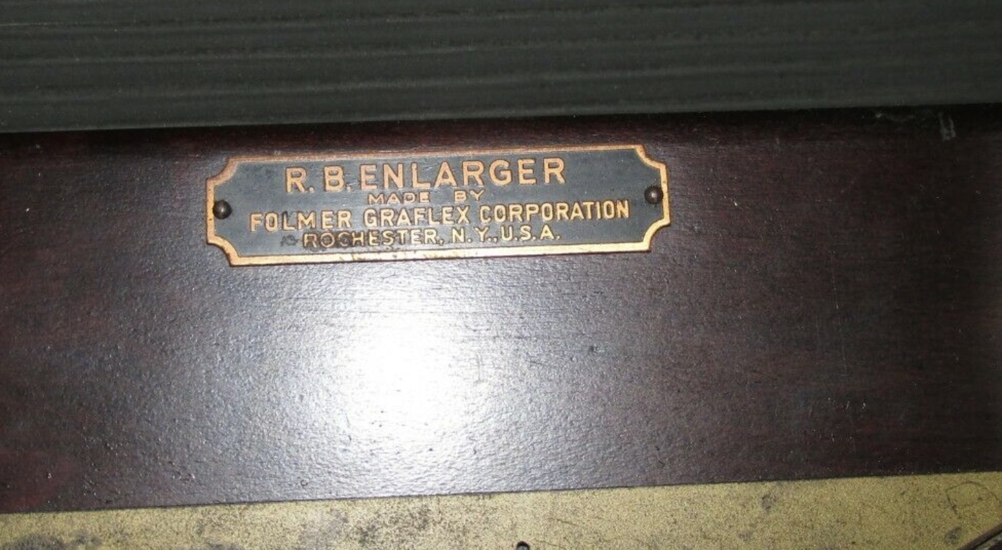

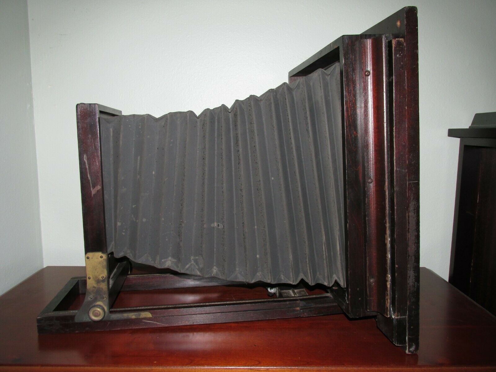

I saw this for sale. Looks like an enlarger that is put in a window and uses sunlight.

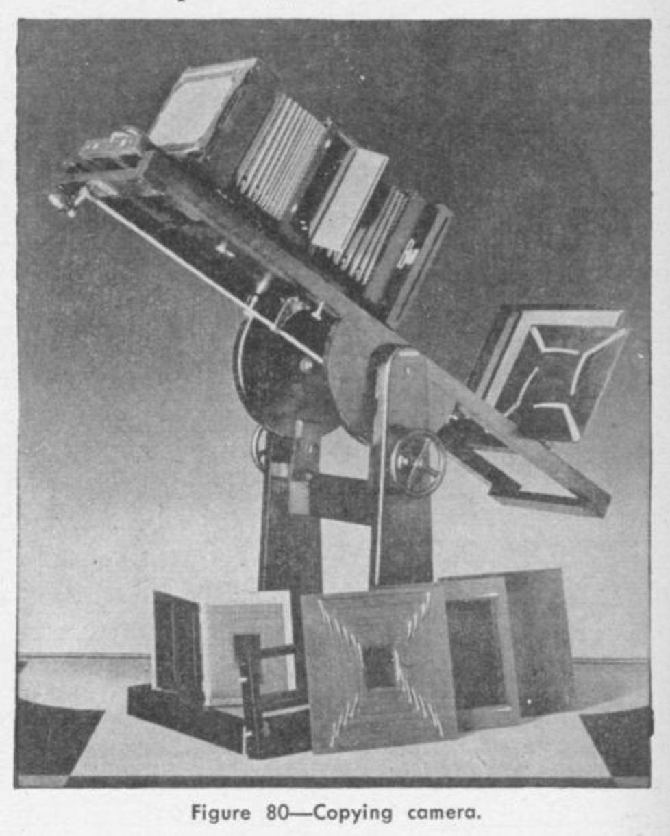

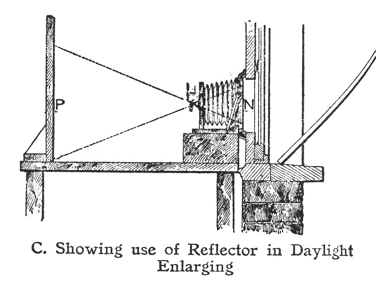

It's more like a process camera. Window enlargers had a mirror, to get skylight, and I'm pretty sure the early stuff used printout paper. But you could mount anything in a window. It's a RB!
Seems to me that a process camera would provide some sort of ground glass for focusing and the ability to insert film carriers. That, and the ad calling it an enlarger makes it seem that this was, in deed, an enlarger. Note that "window" isn't mentioned in the original ad copy--just that it goes in the wall, with the "light" outside the darkroom.
The reflector or mirror would be mounted outside.

I believe the enlarger is based on their 8x10 field camera. The did have a process camera that could also enlarge, but it had a much bigger front standard.

The instructions for the camera tell you that the camera goes in the darkroom wall, with the light in another room. I would postulate that one assistant would place plates in the carrier while the other dude was in the darkroom with a easel and a metronome. When everything was ready the guy in the light would open the window, or set off a box of highway flares :laugh:. Hell I don't know. Sunlight is pretty cheap.

No need to go outside to change the negative, the negative carrier slides out from the side. It the inserts also rotate.
