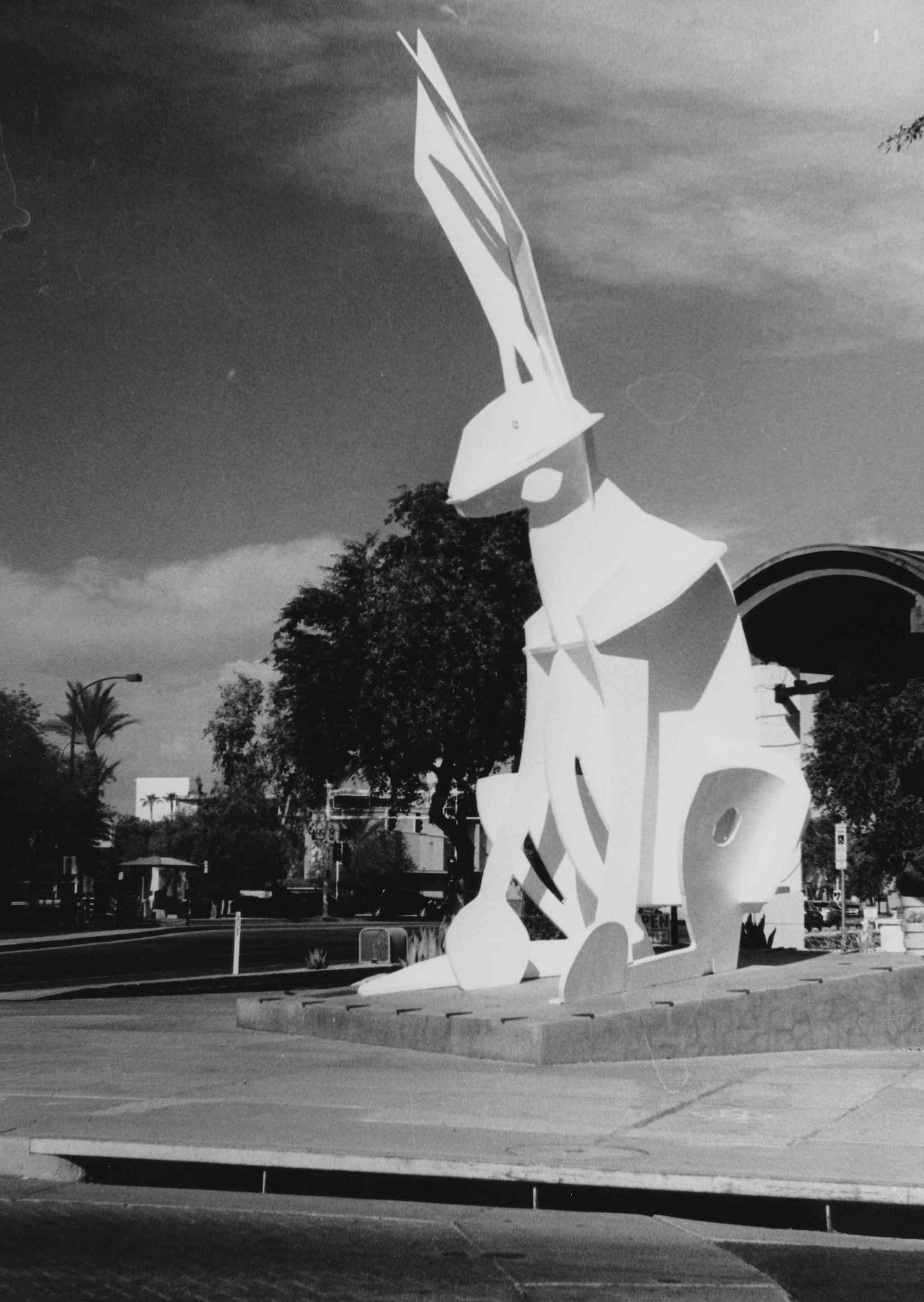

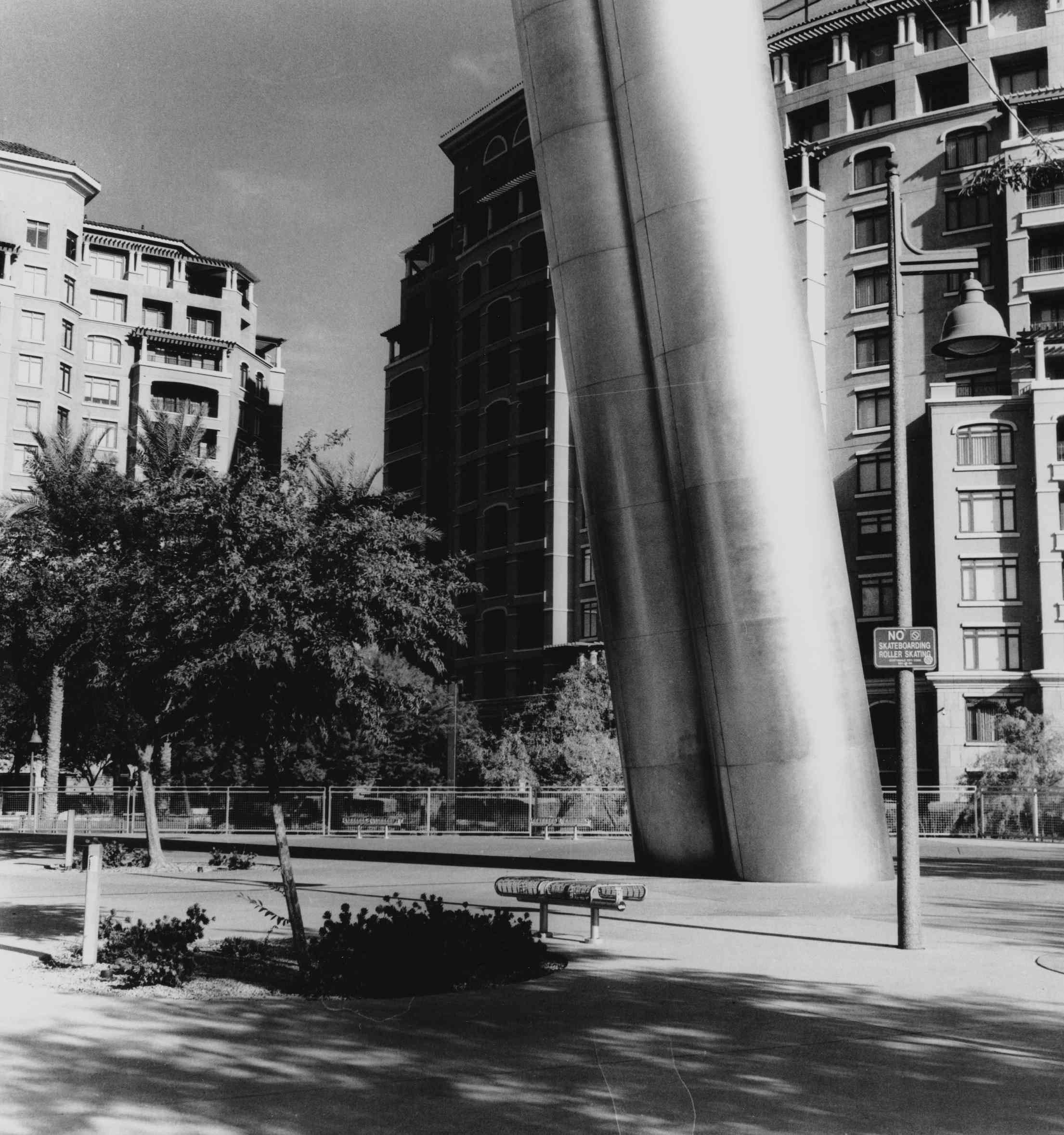

Attached is 2 test prints, film is Ultra Fine, 400 shot 6X6, rated ISO 200, Yashica D, orange and red filters, MCM 100 1:5 24 hours at 40 degrees. No bromide drag, grain is about I get with MCM as are the tones when used stock at 75 degrees. The rabbitt was cropped otherwise straight split contrast printing.

Nice prints but apart from developing to gamma infinity the method does not have much to do with Mortensen.
His process [ in his book ] involved a photographing a subject of low brightness ratio and developing to expand the tonal range.
I agree, lockdown is getting to me, looking for experiments. The only advantage that I can see with ultra cold is maybe 4X5 in a Yankee tank, no need to mess with filling the tank in the dark, agitation is simple, but don't know if I want to wait 24 hours for negatives. I was surprised that it worked at all, thought the emoustion might come off, or the film fogged.
