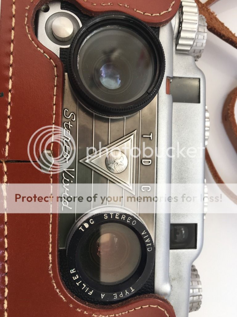

Here are some pics:

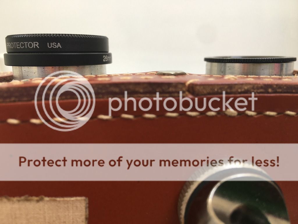

Here is a side view with one filter and step up, the other lens just has the TDC filter on it:
Hope this gives more of an idea how tall the filters and rings are.

Hi. Yes it worked perfectly. Just what I needed for the strong Aussie sun! I just googled the step up sizes I needed and some popped up on eBay!
