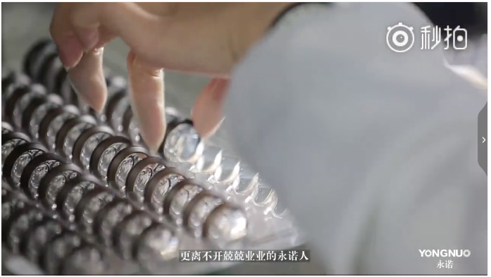

One of the first links I had found indicated YongNuo were a Distributor, but, of course I'm reading some translation to English. A little more research and I found the video in the link below. There, it does look like they are actually assembling the lenses at the factory, but they don't show any of the glass production, grinding or coating in the video as one might show in, for example the Nikkor video farther below. So I'm still not convinced they actually make the lenses; need to do some more digging....
https://www.weibo.com/tv/v/FCY5u0KRI?fid=1034:b8b2e71301f10d04237e9e2009d02027
