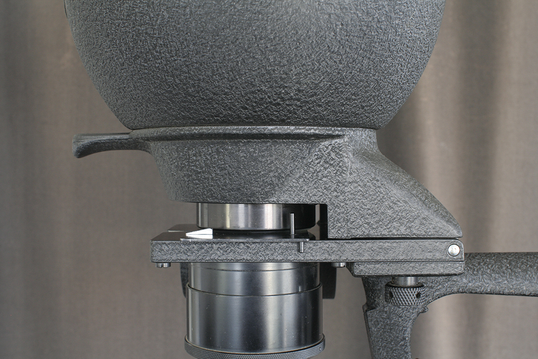

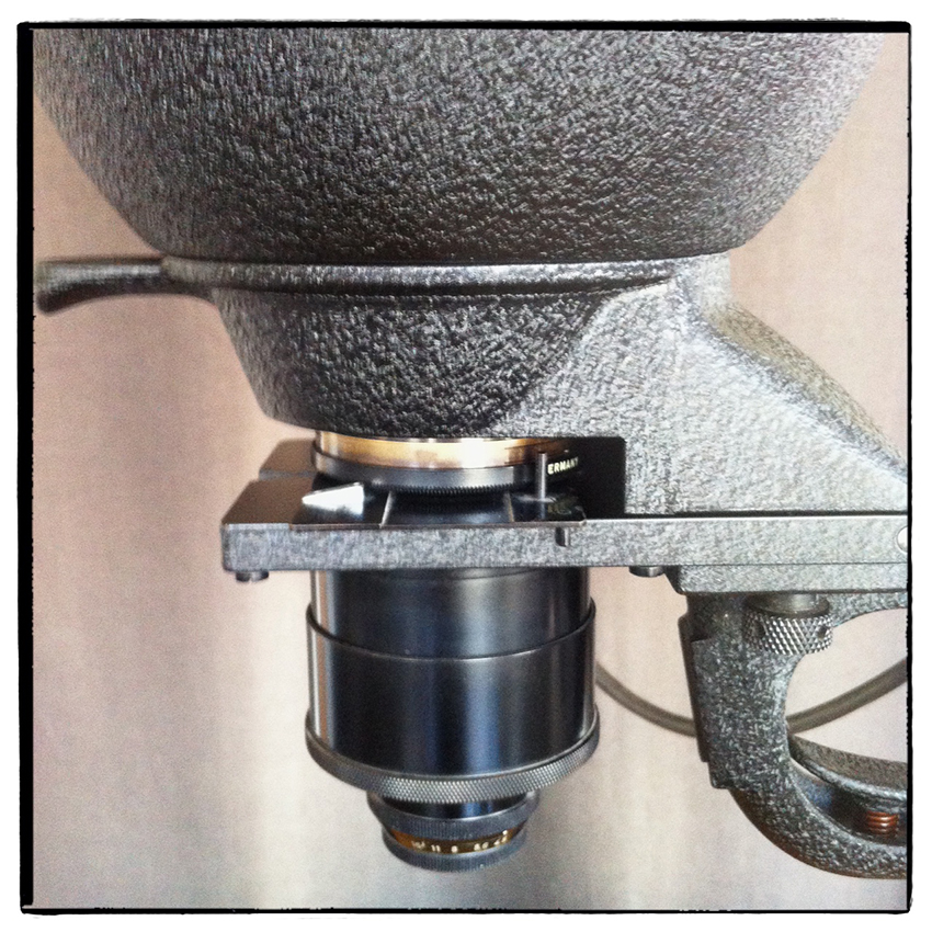

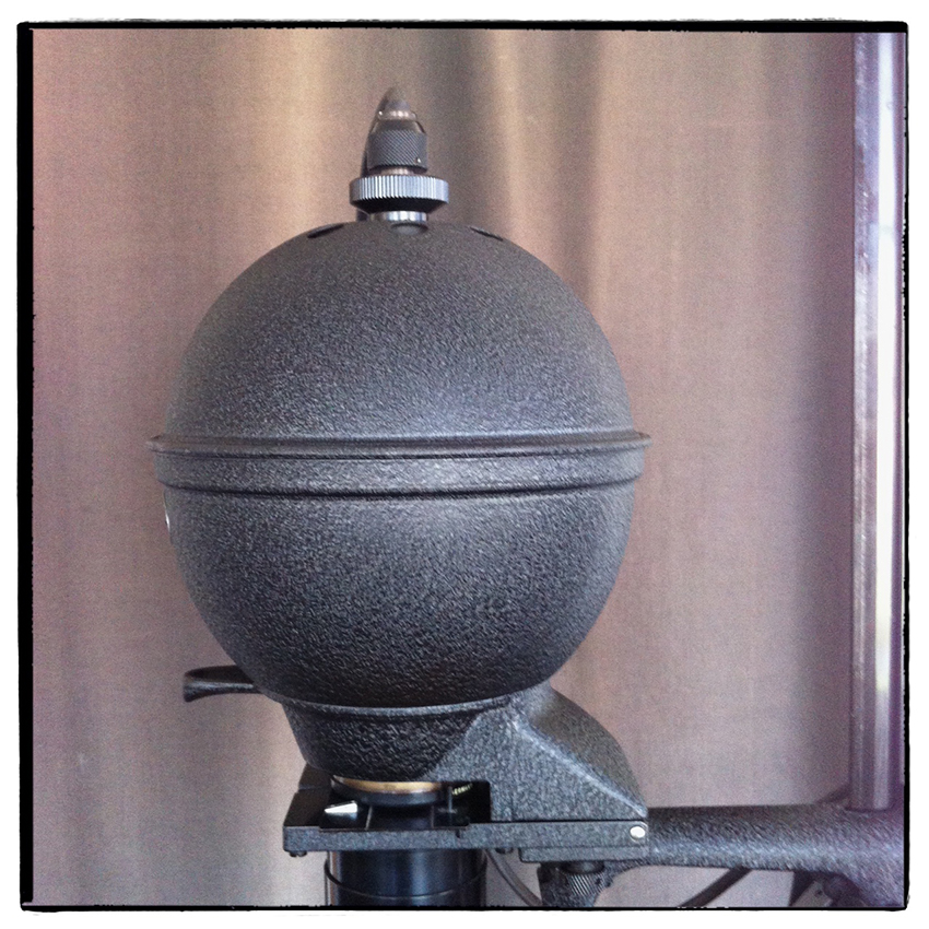

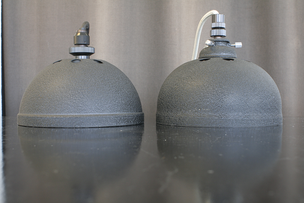

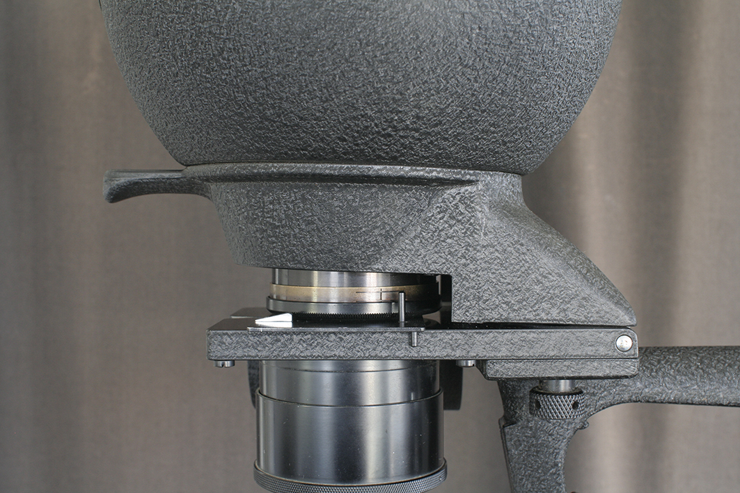

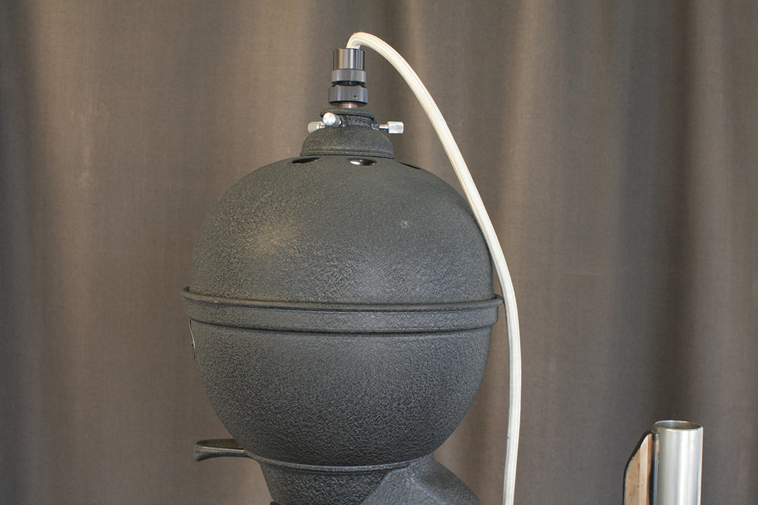

Chip, ok this took a little longer: I checked with a black Valoy II.
The IC top half of the head fits the Valoy II fine. You'd have the advantage of the more sophisticated up-and-down mechanism. Otherwise there's not much difference.
The IC AN glass fits the Valoy II condensor, but there's the problem that the enlarger head gets tilted because of the added thickness of the AN glass.
I attach some pictures.

In the last picture,showing the tilt, it looks like a knurled screw under the back. If it allows the head to be removed, why not shim it to level?
Shim the knurled screw, or the head? I am not sure what to shim is?

The head is still tilted and I don't see a way around it. It will cause wrong illumination and probably not 100 % flat pressing down of the negative.

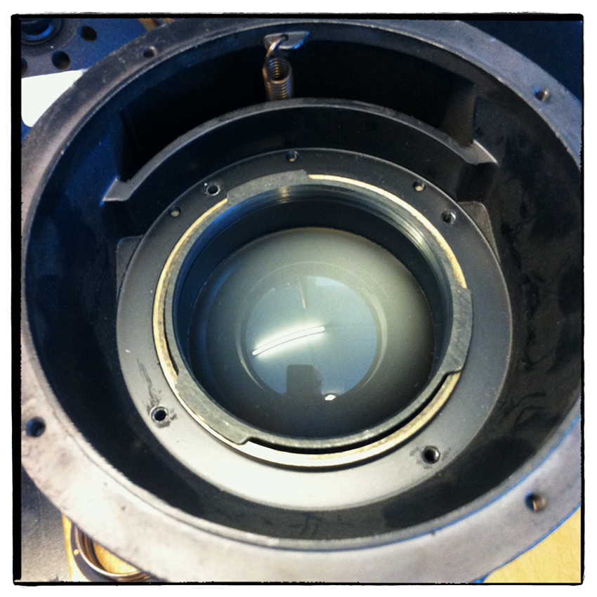

Chip, ok good news, I got it right today. This morning I could finally concentrate on it. Yesterday I placed the 3mm spacer ring in the wrong place.
Today I simply put it under the bayonet flaps of the condenser and therefore raised the condenser unit (including holder, spring, flat ring and the condenser) 3 mm. That being the thickness of the 1C AN glass. I don't think Leitz ever intended it for this purpose with the Valoy II, but it works perfectly. The only lost function is you can't remove the condenser anymore downwards. If you want to give it a good clean, you will have to remove the lower half of the head (4 screws) and the condenser holder (4 screws). All quite easy.
Sorry for the poor pictures, but I think you will understand. All you need to do is find the 3mm spacer ring.

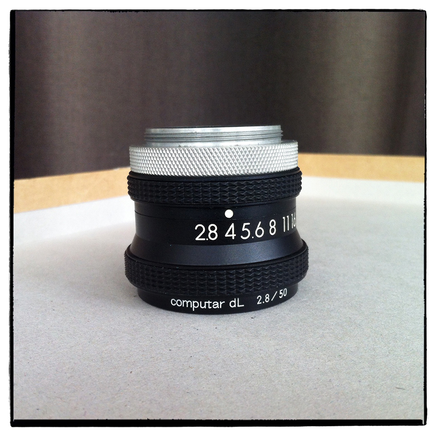

The Computar I have (50/2.8) gave me small problems to install in the Valoy II. The usual Leitz 17675 ring does not screw on, the lens barrel being too large. Maybe an older Leitz ring will work as some of those do not have the inner screw thread. I found another brand adapter ring which works fine and brings the Computar down just enough to see the aperture numbers. It will all depend on the build of your Computar. I am curious to hear what you find working with that 1.9 !

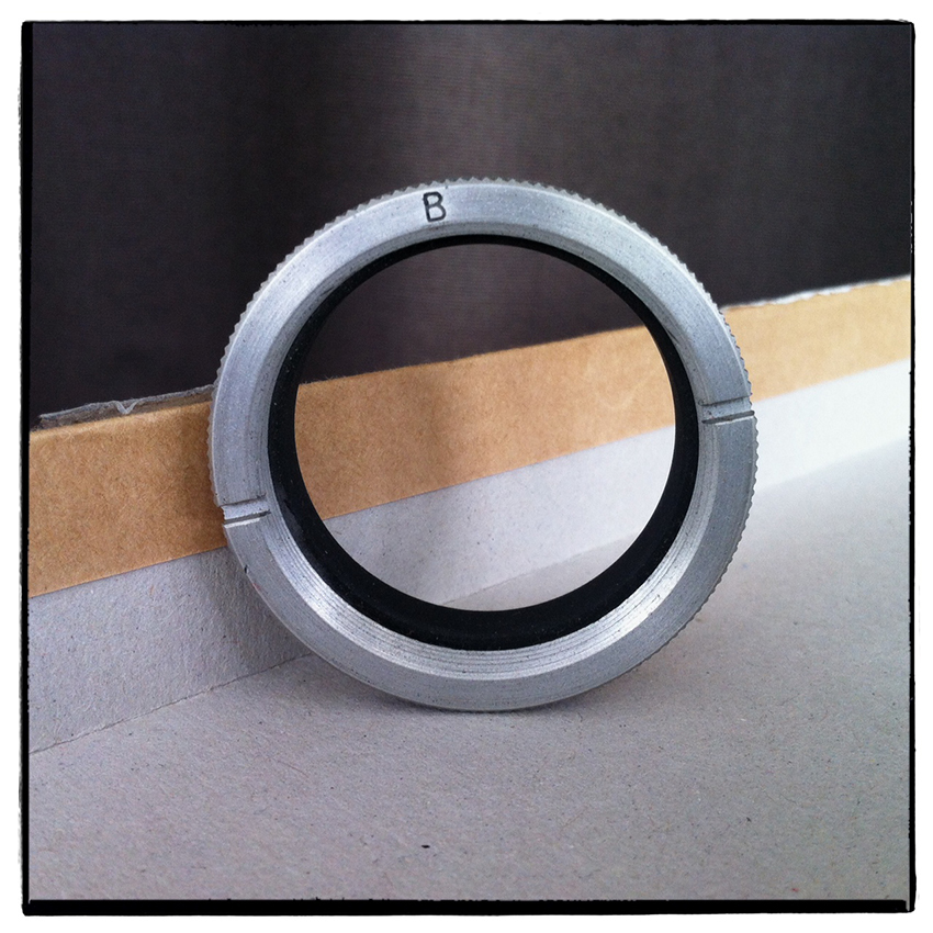

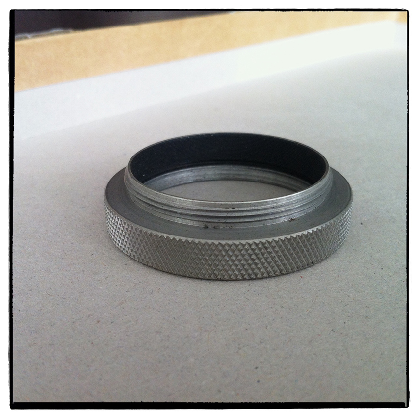

Chip,
Perhaps this helps: I found an extension ring that makes it possible to use the Computar 50/2.8 with the Focomat IC. It was sold as a Leitz B extension ring for Focomat and Reprovit. It measures only 7 millimeters, or 11 millimeters with the screw thread.
I could not use the Computar because the normal Focomat extension ring 17675 doesn't work with this lens. This 7 millimeter ring works fine, even the automatic focus stays ok. Perhaps your 50/1.9 has a similar barrel?
