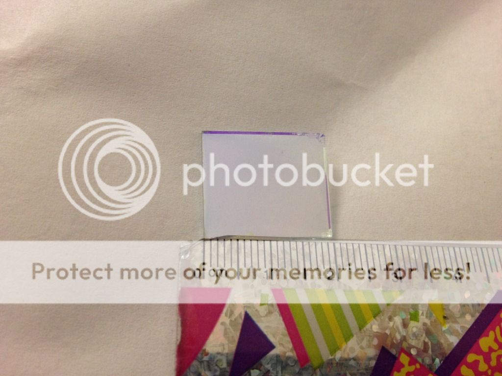

Anyone have an idea how I could find the below, but red, photo-paper-safe, has to be glass, heat resistant, 20mm long (long side measured below), 17mm high and 1mm wide, and preferably cheap...thanks in advance :smile:

Hi Andy.
Your request as presented does not give enough information to be specific. I think it would be a good idea to tell us what you are thinking of doing.

Yeah figured as much, I wanna put a saftey filter in my dichro enlarger head to be able to toggle with and w/o safety filter. I know I could solve for this in a number of ways (under lens filter, etc)....
But was hoping somone would say...."yeah buy this, and have a glass cutter cut it for $5...."
What is a "this"?
Maybe that?
