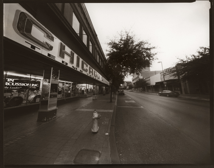

I don't know if the original posters are following this thread anymore, but Lens and Repro is currently offering a "135mm Goerz Hypergon, Rapax shutter (!) with 3 filters" for $1500. Bit I'd get more info on the lens before buying. The Hypergons had their front and rear elements spaced extremely close together, and there wouldnt be room for separate shutter and aperture blades between them. The aperture on a Rapax wouldn't close down that far anyways, so maybe it was removed...
I have a 75mm Hypergon with the fan on an 8x10, and it's a trip to use. All exposures must be at least 1 to 2 seconds long to give enough time to use the fan, and the time the fan is used varies because of changes in the reciprocity curve. Composition is best done by looking at the scene outside the camera, as focusing is at about f/22 in the center, and maybe f/50 at the corners due to fall-off. And one must be very careful about leveling the camera. I must have bumped this one very slightly after leveling it...
