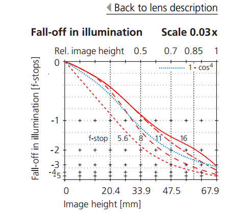

You may also check datasheet to see the fall-off amount depending on aperture yopur lens sports.
Super Angulons (IIRC) are Biogon design derivatives sporting a lower fall-off than the one calculated from the cos^4 rule, this is achieved by an optical hack named Tilting Pupil.

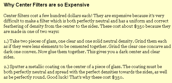

Dan, the information you show is of high value, still that Rockwell's page explains (bellow) that there are two kinds of center filters, one manufacturing way is more expensive than the other, IMO it is a quite interesting knowing why.

https://www.kenrockwell.com/tech/center-filters.htm

Dan, of course, as we close 2 or 3 stops then fall-off stabilizes, but from f/8 to f/11 we may have 1 stop missmatch.
This is the grandagon 45 but the other focals covering sheets are similar.

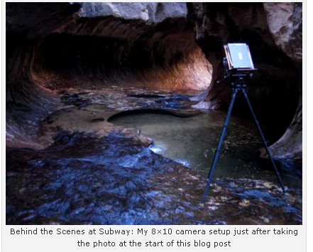

...but know let's see a practical situation where the CF is a pitfall, here (The Subway, Zion Park) velvia exposure takes 15 min
https://benhorne.wordpress.com/2009/11/16/my-zion-subway-experience/
Then with CF we have to use a large aperture if not wanting troubles, with no CF we may get a better shot.
My statement was a bit exagerating, as that effect is from max aperture to f/11 or f/16, depending on the lens.
