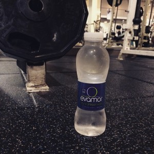

Wide mouth liter/qt soft PETE bottles are my preferred chemical storage system (anti-PETEites notwithstanding). They were pretty widely used in bottled water and soda for a while and fortunately I saved about 6 of them, but a few years ago they suddenly disappeared from the market. Now qt/liter sized soda and water only seems to come in narrow mouth bottles, and the PETE used in wide mouth sport drink bottles is very stiff and very poorly suited for squeezing the air out.
I've been looking for some of the old style wide mouths for years and found something pretty close. Evanor artesian water comes in a 1 qt, soft, squeezable PETE with wide mouth. I bought 6 of them, which is all the (Cub grocery) store had. It seems a bit more crinkly than the older stuff so it may not be as durable, and I wish they were liter instead of qt, but it's otherwise a very adequate substitute. And the water isn't half bad either.
