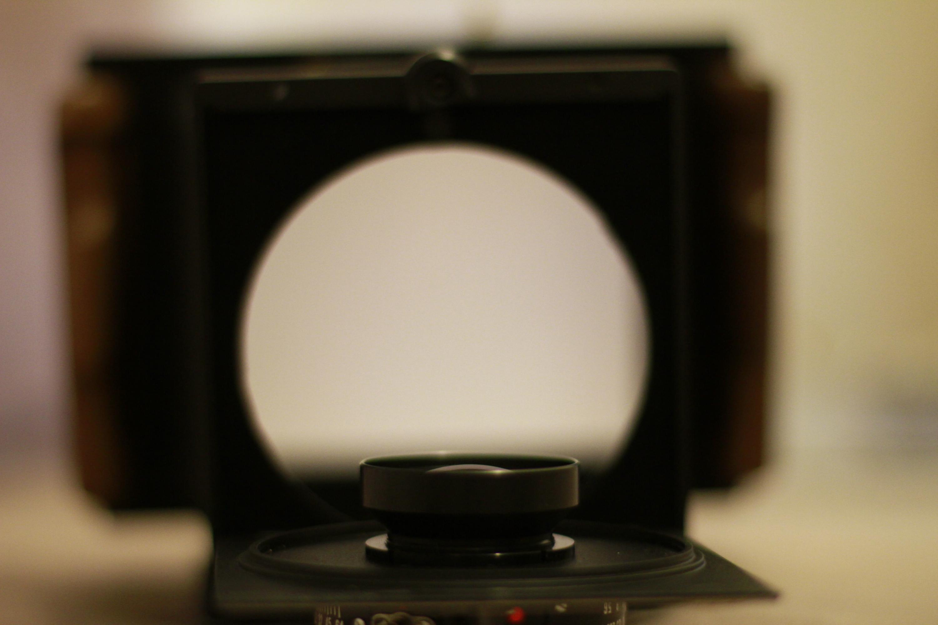

One of the reason to start this thread is so I can understand wide angle lenses more because I dont use them even in 35mm.
But the other one is because of this Unique camera that I have acquired.
Will post a new thread
