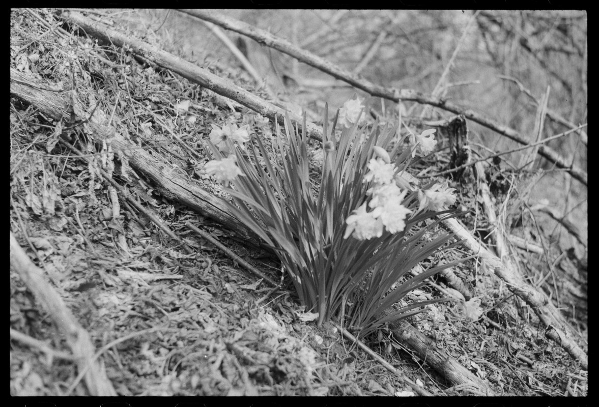

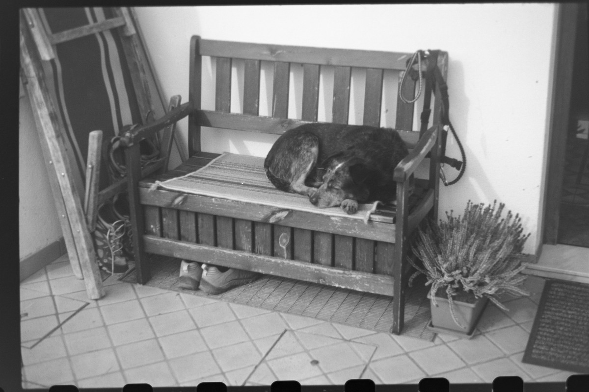

Since a couple years ago I have a strong passion for Leica STM (Screw Thread Mount) cameras. As you probably know, Leica STM cameras were made by Leitz from 1925 (first Leica 35 mm camera with a fixed 50mm Elmar lens) to 1957 (Leica IIIg, interchangeable lens). I own several Leica STM cameras, from Leica II (1932) to Leica IIIg (1956), and I use them regularly: these are great cameras, and a lot of fun to use. That said, my first experiences with these cameras were partially ruined ‘cause, developing my films, I experienced frames like those below (made by my Leica II):
[/url
[url=https://postimg.cc/bd6sjKb8]
Obviously, there was something wrong, in fact the frame keeps partially the holes of the film. Why? Well, if you take a look at the Leica Manual book (in this case, 1938 edition), you may see that Leitz made his own rolls, known as FILCA and then IXMOO rolls:

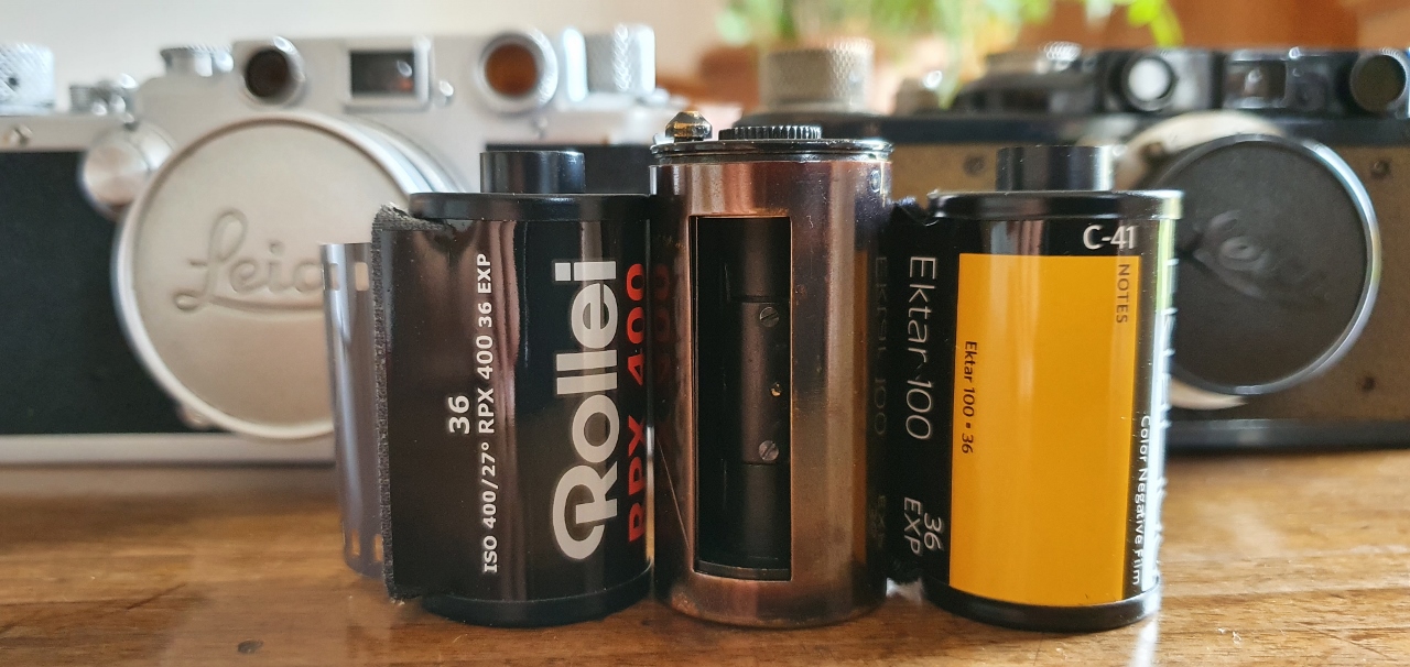

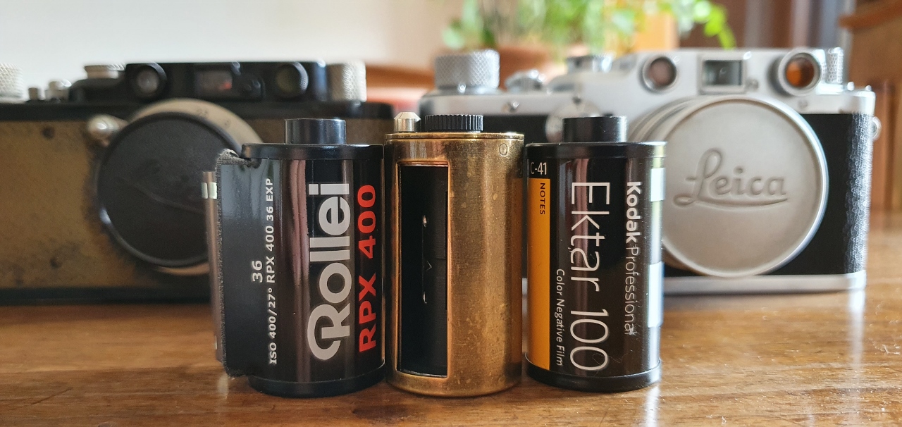

These “Leica rolls”, made by brass and aluminum alloy, are slightly different from the “normal” rolls we use today, as you may see below:
[url=https://postimages.org/][/url

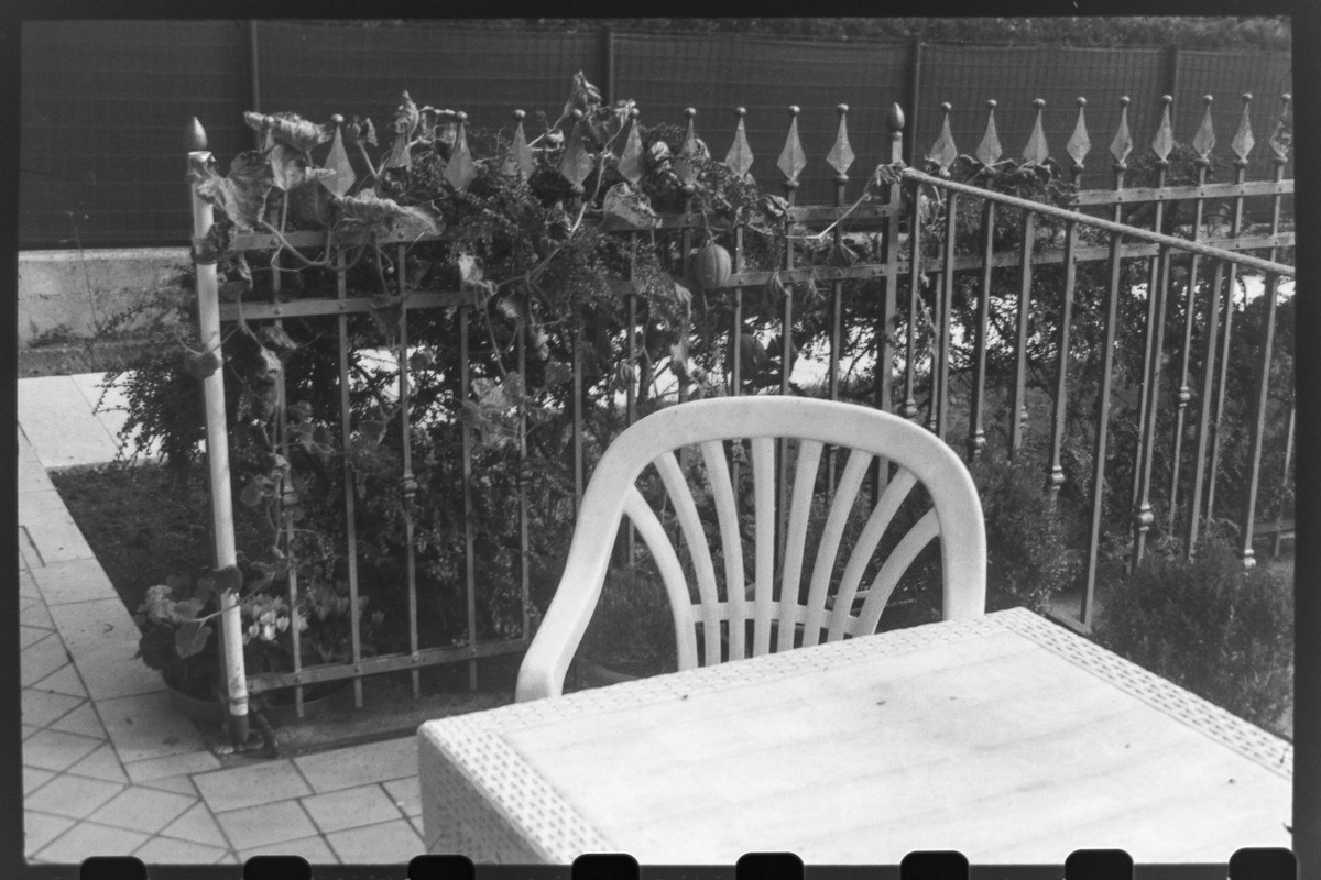

and I soon realized that Leica STM cameras were designed for these kind of rolls. In fact, if you use the FILCA or IXMOO rolls, you will obtain frames perfectly positioned between the film holes, like this one (made with my Leica IIIg):
[url=https://postimg.cc/V5YPFvJL][/url

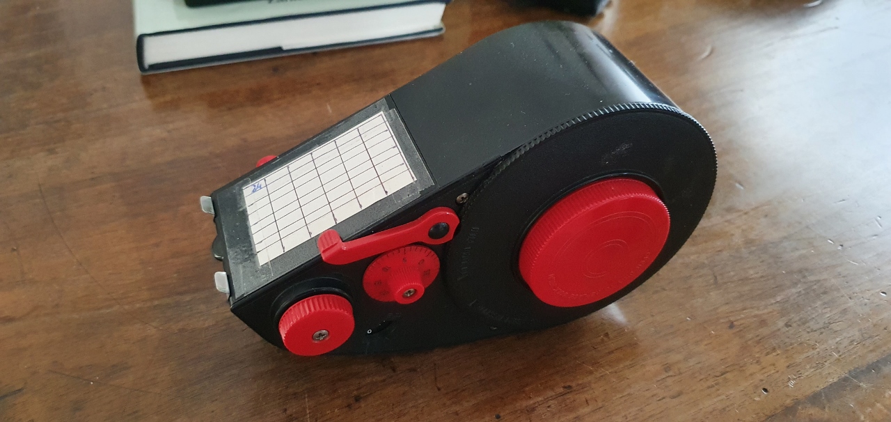

Obviously, to use FILCA or IXMOO rolls, you need to charge them by film using a film winder like this one:

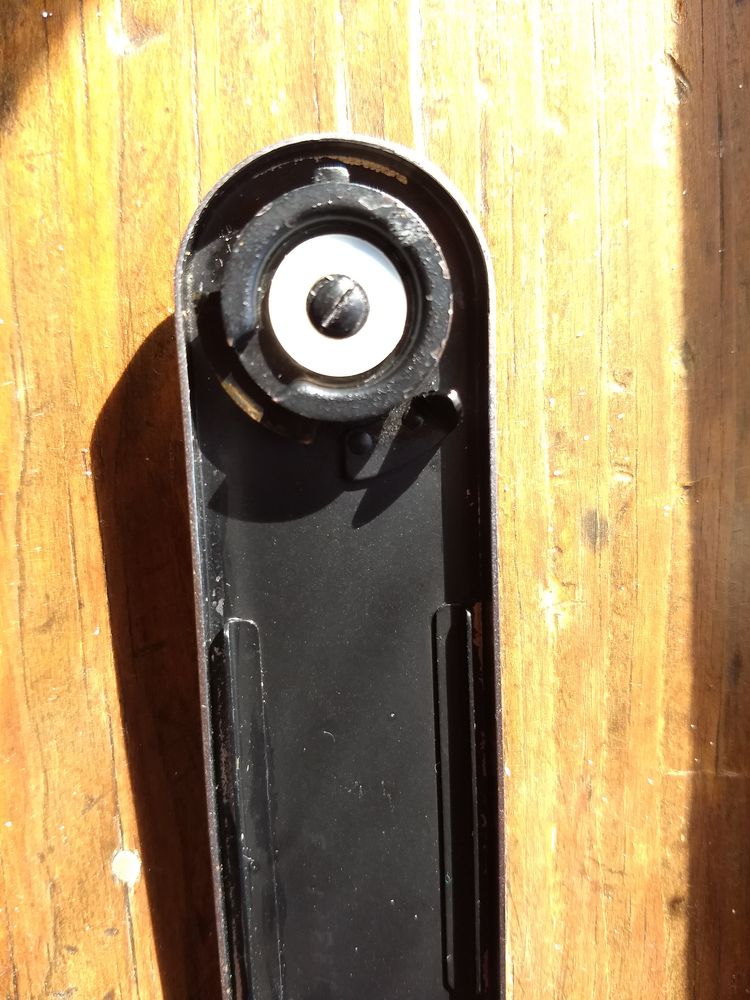

Here is a solution: add 1 or 2 thin nylon or teflon washers to the plug that pushes the modern film cartridge up into the body of the camera. I had to enlarge the diameter of the holes to fit around the screw. See the attached picture.
Nitroplate, Kodachromeguy: thanks for your contribution :smile: Brilliant and easy solutions if a FILCA or IXMOO roll it's not available or you don't want to use it for any reasons.
