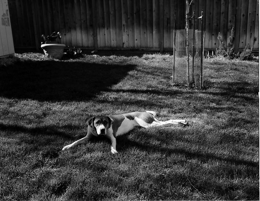

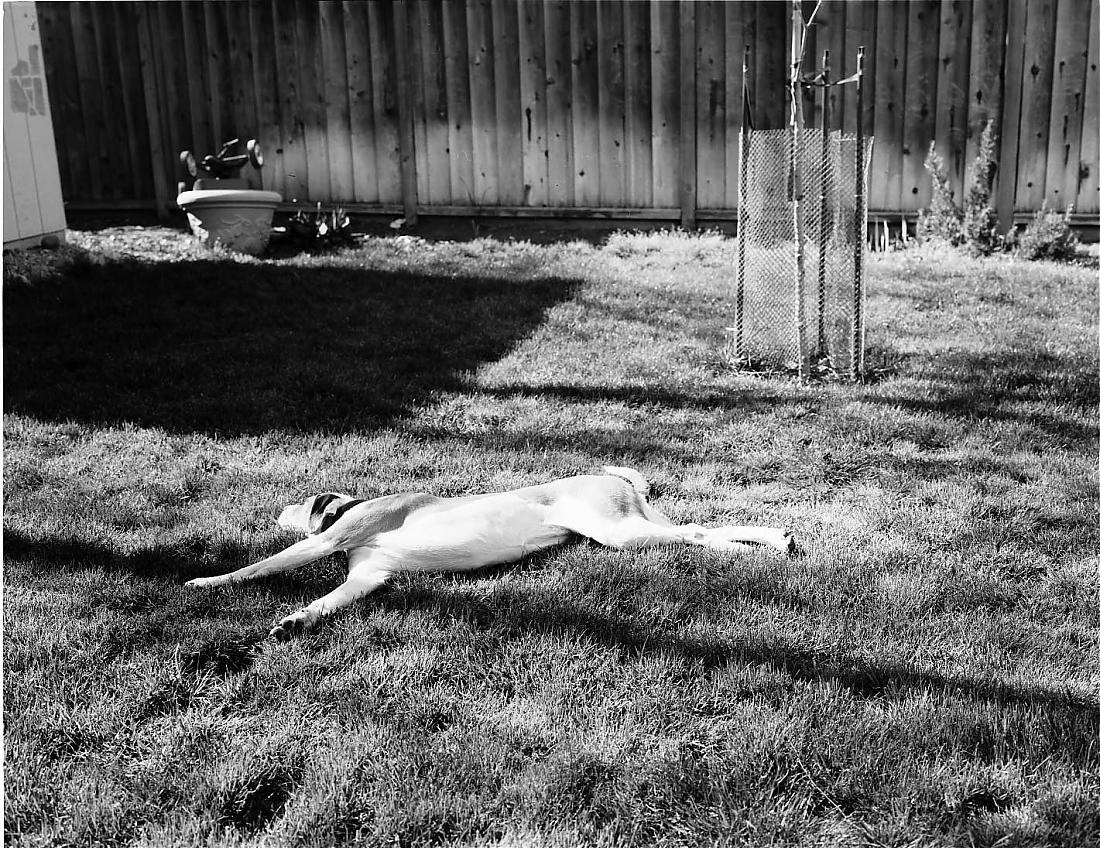

So I did and here is a brief summary of the experiment and some results...
I mixed up two developers. Developer A is: 10g Metol, 100g Sulfite, 8g Borax and water to make 1 liter. Developer B is the same as developer A except that B has only 25g sulfite per liter.
I shot six sheets of fresh Illford FP4+ rated at box speed. Both sheets on either side of a film holder were exposed exactly the same and, of course, were of the same scene at nearly the same time and same light. Two scenes have what I consider to be flat light and the third scene is contrasty afternoon sunlight.
One sheet from each film holder was developed in Dev. A and the other sheet in dev. B. In both cases, the dev time was 8 minutes with continuous rotational agitation. I used a Jobo Expert drum on a unicolor roller base with the direction reversing switch bypassed (so, it never changes direction).
Examining the negatives it is immediately apparent that dev. A built up more negative density and that dev. B wasn't able to hold the shadow detail.
Some scans follow - these are unadulterated negative scans - please forgive the crudity of the presentation - I simply scan, rotate, remove the color and save. Nothing more.
Dev A is on the left.
These were done with a crown graphic and 150mm Xenar in flat lighting.
dev A is again on the left.
Modern, multicoated and super contrasty 1355 Nikkor-W in harsh light.
