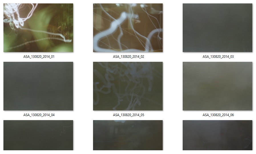

Hello guys,
im a newbie in analog photo. I bougt Ricoh 500 gx and I used Kodak Vision 3. I have pretty good photos in my first roll. But in my second and third rolls, the result is so bad. Theres no picture captured at all, just shadows and smoke. Im pretty desperate. Note: I always shoot photo with sunny 16 rule.
Here i attach the photos from my second and third roll. Any feedback or comment will be very very appreciated. Thank you guys.
Regards,
ambar

Sunny 16 only works out in BRIGHT SUN.
Move into shaded area, and the recommend exposure becomes 1/ISO f/4, or -4EV dimmer light. The Sunny 16 rule is not always appropriate!
I see instead a shutter issue.

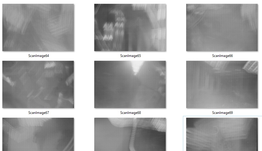

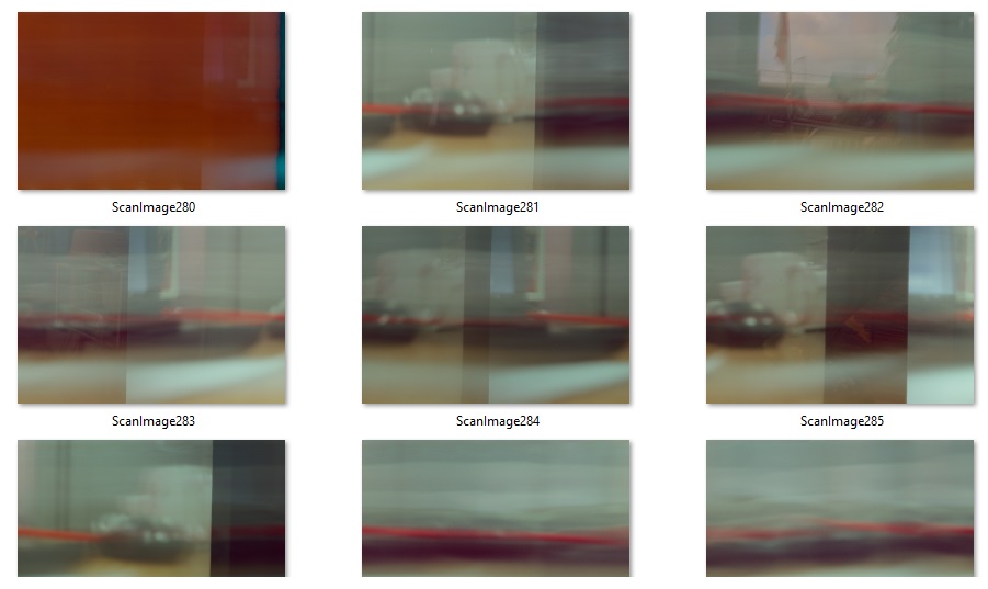

Dear Wiltw, thank you for your feedback. But, there some shoot in my fourth roll that i didnt use sunny 16 rule and still no clear photo. Here i attach my fourth roll result, i just received the devscan result.

Looks like to me, most of the photos have quite a lot of motion blur, which would be caused by the shutter staying open for far longer than you intend. It looks like some frames may be overlapping, which isn’t a shutter issue, but might be related.
If the camera will fire the shutter with the back open, you can check the general operation. Fire the shutter at all its speeds, and see how it responds.
For the photos made in daylight, what shutter speed settings did you use?
Are you using the sunny 16 rule because you have no battery in the camera?
If you can give a few more details, please, it might help.
  • Was it sunny bright day, cloudy or over cast, dull wet day, etc ?
  • What were the camera's settings, (we know sunny 16 for the aperture), and more importantly what shutter speed had you the camera set at? (eg: 500, 250, 125 )
From what I have seen in your posting of the images, I agree with AgX that is looks like a shutter issue.
If previous rolls were OK in terms of exposure and sharpness then clearly something has happened to the shutter mechanism since it was last used. I can think of nothing else that explains what we are seeing

I think that camera of yours has seen better days. Maybe take it in for service or try a different film camera and see if your results improve.
Your camera has a leaf shutter, not uncommon for leaf shutters to get sticky, best way is to leave the camera back open, set the shutter to 1 second and fire the shutter. You should be able to see if the shutter opens for about a second, does the shutter completely close or stays open too long, then work your way up to /1500. You should be sense if the camera is staying open longer than it should.
But how can that banding be explained, especially with the shutter being of the leaf type?
Good question, I assume that it has a leaf shutter, the manual says electronic flash syn at all speeds, then again the manual does not list the specs. I checked the manual the lowest shutter speed is /18th , so on blub hold the shutter open and and look through the back to see what is going on.
If the film was scanned by a lab, the "banding" could be caused by frame mis- alinement in the scanner. Because the film has no definite space between the frames, the scanner does not aline each frame correctly. (just a guess).

Hello guys, thanks bunch for the feedback.
Update per today, I already used 3 rolls of Kodak Vision 3 and 1 roll kodak colorplus 200, all 4 rolls came in similar type of photo. all photos, I shot outdoor and indoor from morning till evening. I have no battery in my ricoh, thus i used manual.
I tried clicking the shutter with the back open and the shutter worked normal.
I remember now, after my first roll, i clicked and played with multi exposure button and self timer button. May it be related to multi exposure? Because my first roll were fine.
hi ambar
I hate to have you sink more $$ into your camera than you might want, but you might consider taking it to a repair person to have it overhauled, and make sure the shutter is working and the film advance is working as they are supposed to. your camera ( I saw its manual ) looks very nice, have you studied the manual ? maybe you have it on aperture priority by mistake, ( and its sticky ) and since you do not have the battery installed the electronic eye doesn't work and it releases the shutter at the default ( SLOW ) shutter speed it is set to go at. its like when your "check engine light" flashes in your car and the car goes in "limp engine mode" and won't go over 35kph. the multi exposure button is so you can make double exposures it allows you to cock the shutter without advancing the film, and it might be sticky .. and that might have something to do with the overlaps, or it could just be a advance and shutter issue or a scanning issue...

I don't think this is a camera problem. I think that you are setting the shutter speed far too low. I would stick to 1/60 or faster (preferably faster).
A novel theory but one we can discount or not pretty easily
OP what were your shutter speeds? Were any below 1/60th and in what scenes involving movement and what kind of movement and light conditions?

dear guys, i set shutter speeds same as my film ASA. I usually shot in daylight.

Multiexposure means the film doesn't advance and it will take the next photo on top of the last one.
