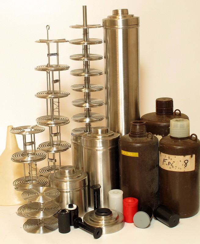

Here are the stainless steel developing tanks and reels that I use for developing 35mm and 120 black&white negative roll film and color positive roll film.
The small 4-inch tank holds two 35mm rolls or one 120 roll.
The medium 7-inch tank holds four 35mm rolls or two 120 rolls.
A large 17-inch tank holds eleven 35mm rolls or six 120 rolls.
My largest 22-inch tank (not shown in photo) holds sixteen 35mm rolls or eight 120 rolls.
I do not remember what I paid but when I factor in the money saved by developing my own film, the cost was well worth it. Thus far, this equipment has lasted me a lifetime.
