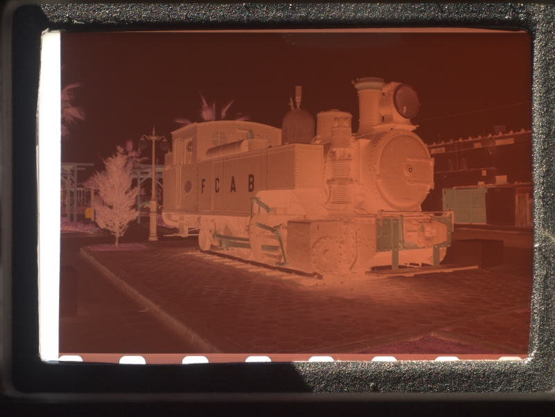

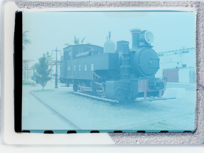

I think RGB transfer functions shown in the density graphs are for all the layers including the orange mask.
The first image below is a raw of the C41 neg
The second is inverted (only) without any color balancing or gamma correction. Note the blue cast.
It could be that Backmost's scan is just like that, an inverted raw positive, and need to be post processed.
