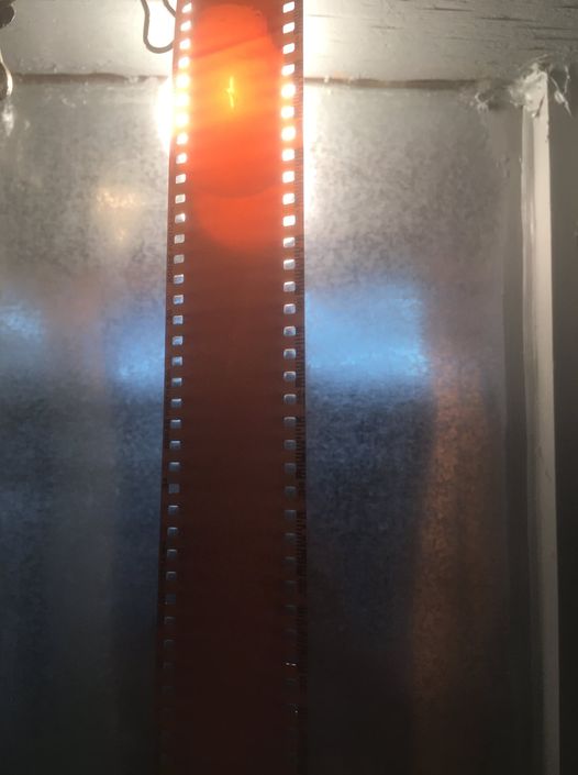

I use a rotational film processing machine to develop my film (filmomat - videos on youtibe)
Sometimes - especially when I only process one roll of film at a time - I'll rin intto an issue where soe parts of the roll have these shadows coming from the sprocket holes. The film I didn't shoot myself so idk if there are any other thigns that could have happend to the film. But does anyone have advice on al lthe possible reasons this owuld happen? Photo below

I can't see the shadows in the photo you posted.
But generally, areas of increased (or in some cases, decreased) density near the sprocket holes are referred to as surge marks, because the form of agitation and/or chemical flow used is causing developer to surge through the holes. If the movement of developer is more rapid adjacent to one part of the film when compared to another part of the film, the development will be un-even.

What do you mean by shadows? Increased density? If so, them that's from surge marks, usually due to excessive agitation. If it's decreased density or clear, that's bromide drag due to insufficient agitation... Which can occur with stand development.

Hey everyone - please keep in mind I'm using the machine I mentioned to process the film. It is always constant agitation and this only happens sometimes. I'm trying to figure out how to avoid this from happening. It usually only happens when I have one roll by itself in the tank

Your results suggest that it's not a good machine.
Or that is designed in a way that requires you to always have at least two reels in it.

As matt says
id be assuming you have one one reel in a two reel tank and the one reel is banging around loose in the tank creating surge marks. Do you put a second empty reel on top of the loaded reel in the tank?

Yes, if we could see these marks. I can't.
Yeah, if I look very, very hard, I *think* I see something about 2/3 down that film strip on the inside of the sprocket holes that might be 'surge' marks. However, they might as well me uneven drying of the film as it's still partially wet. Important to note is if these marks are also still present when the film is completely dry. 35mm tends to dry unevenly.

I don't see much of it in your example. I had some of it myself. Anyway, the most lkely causes are agitation turbulences around the holes during processing and light-piping through film edges during film handling. In any case, they have no negative effect on image quality and I have, therefore always ignored them.

For me it looks like some light leak (but it's very hard to see)? .....maybe happening during loading the tank. I had this once, where i forgot to power off some equipment (with some running status led on it) in my darkroom, where i do prepare the tanks.

I had a look at the posted photo and can barely see what appears to be lines from sprocket holes on one side to the other. If the OP could post another photo, maybe close up of the film, it could help.
This to me, it looks like stress marks not agitation surge.
Stress marks can be caused when a film is rewound the wrong way in the camera. (So instead of rotating the film rewind lever clockwise, it was done anti-clockwise.)

I am amazed by how many people said they don't see anything. Aren't you all photographers and supposed to have decent (even calibrated!) monitors and a good eye to judge "tonality"? The perforation shadow marks are screaming at me from the posted photo, and I am on a relatively pedestrian Macbook Pro.
Well, I do not see any shadows. AlI see is a glow at the upper edges of the hole, a matter of light piping.
Could you upload a copy of the OP's image with marks you made which then would be screaming at us instead?

The problem with what I see is that surge marks are generally most visible where the film is most strongly backlit. In the posted images, nothing is visible where the backlight is strong. There may be some ghost images farther down, but I'm not confident because if I move my head, those images tend to move as well - I think it is just flare from the backlight!

There's a streak originating from every whole on both edges going outside in, 100% exactly like on this image from this thread.
Thank you. I see so much what I interpreted as artefacts in making that photograph, that still I do not see regular streak marks.
But let's assume they are there, running from the holes perpendicular to the filmstrip edges.
How then do you explain such with this comment on mind of the OP about his processor:
"continuous rotation by a filmomat machine"
https://www.photrio.com/forum/threads/is-this-film-reticulation.179222
In this case I expect streaks running parallel to the edges.
The site of the filmomat shows two different tank set ups.
-) tank mounted vertical, with the bath seemingly rising and falling along the tank axis, perpendicular to the filmstrip edges
-) tank mounted horizontally
The manufacturer of the Filmomat is a member here, but I do not remember that he ever described how he achieved bath agitation. Maybe someone else can shed light on this.

One can clearly see the tiny black lines but, I was searching for the announced shadows of which I saw none.
Well, I "analyzed" countless artefact photos uploaded to Apug, but this is a weird case where we see very different things or rather see them not.
But let us try instead to explain what is assumed to be seen. I already made a step into that direction and found this even more puzzling. Maybe you got an explanation.

Not only have I had shadows bleeding into the main film frame, I also get leading edges of the frames being similarly affected. It does not happen on every frame or every film, but when it does you could bet on it being in the frame you were hoping would be the best on the roll. It only happens with 35mm colour negative film. I put this down to the JOBO rotary processor but seemingly it happened more frequently this last year or so.
The bleeding between frames does not happen when I use 120. Nor does it happen with B&W and more recently with colour 35mm when I hand agitate. Or is it down to the lesser quantity of developer used when rotary processing.
As I said it was only this last year of so that it has occurred, I wonder if the formulation of the chemicals, principally the developer to make it odourless has had any effect, enough to cause this problem

I do not quite understand in which orientation your shadows are are running, but do you see a relation between the orientation of the rotation and the oprientation of the shadows in your case?

The 'bleeding' are always on the edge of the frame in which direction it is wound onto the spiral and closest to the central core
