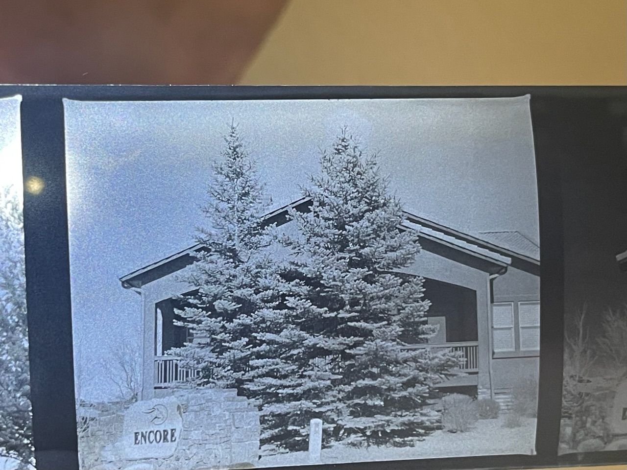

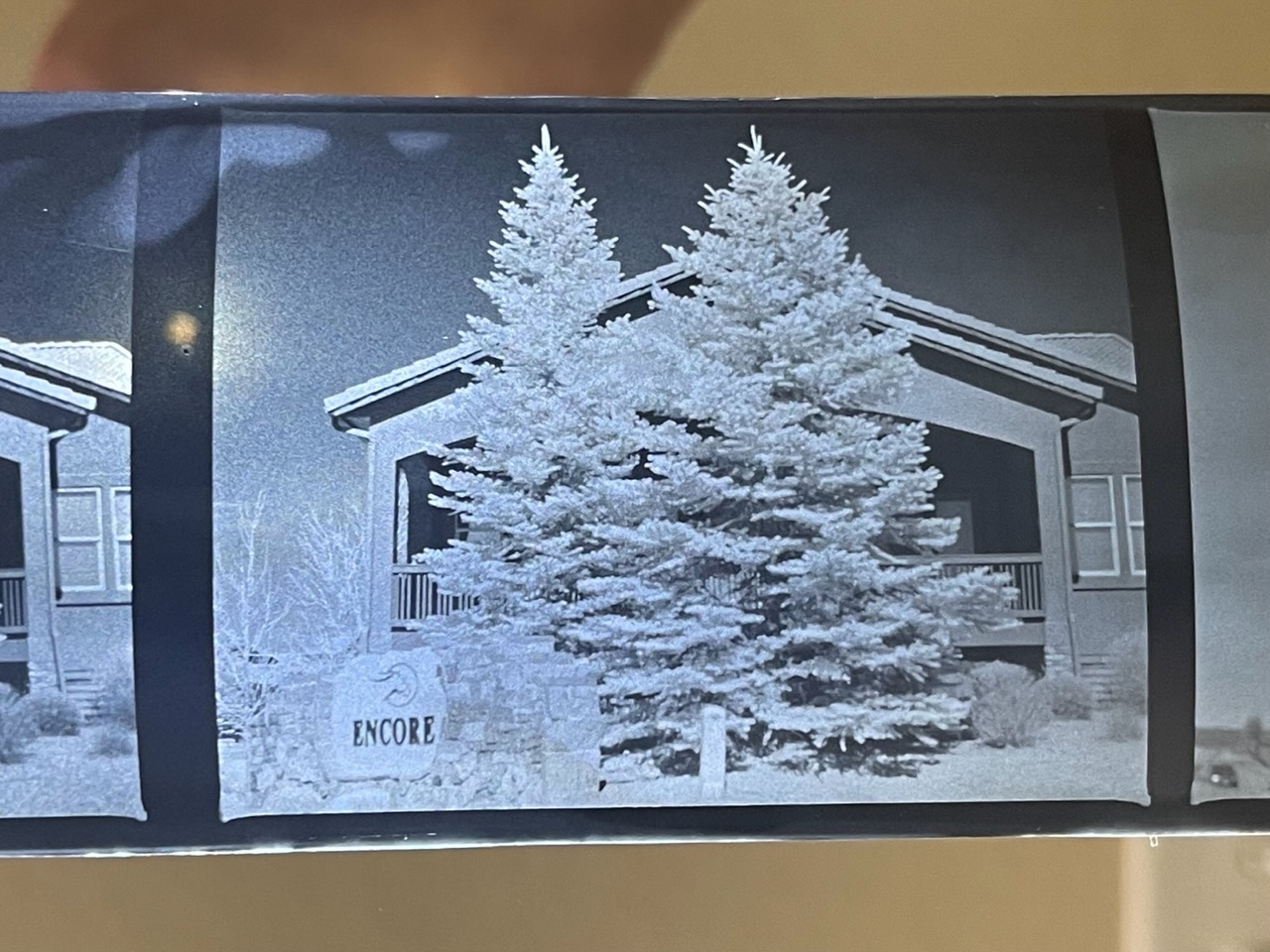

yes, I have some scans of negatives as well as positives. Here’s an imgur album with negatives:
And here are a couple pictures of positives in IR and visible light:
View attachment 348287 View attachment 348288

1. What developer and development time did your lab use? Did you shoot those images at ISO 200? Also, did you intentionally make your home developed film look that way?
2. Where did you get your 70mm film back and how much did it cost you? What do you bulk load it with?
3. The IR positives you showed...That's the same film, just with an IR filter, right? What strength filter did you use? Also, how did you develop them?
My lab uses D-76 and developed it 14 minutes in 1+1. I also did that at home.
however now that I have deved more rolls, I think I messed up exposure or developing somehow, maybe both.
I shot both rolls at ISO 100, which is pretty close to this film’s box speed. The 200 in the name is is ISO-A, a bit different than regular ISO. I’m not sure of the exact difference, but I’m sure someone else on here would know.
Yes, it’s the same film. I used a Zomei 720nm pass filter and exposed at 6-12 ISO on a sunny day.
Slide B&W development is a super fun topic, but also, there’s not really one way to do it consistently as of yet. You just gotta do some research and experiment. There are several threads on here about this process, and the results you can get.
