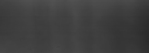

I've been shooting Fortepan 400 occasionally for the last couple of years. I like the look of this film and have enjoyed it's flexibility and it's graininess with Rodinal and Pyrocat HD. With these grainy combos I've been able to live with the occasional pinhole in the emulsion (no I don't use stop bath), as these are usually masked by the grain.
Currently I am wrapping up developing a half dozen rolls of Fortepan 100, a film I've never used before, that I bought overseas after running out of film on a trip. On top of the one roll that tore off the end of the spool and was lost in the field, many, many frames from this batch have what I would call separation lines in the emulsion. These breaks in the emulsion look as if the emulsion pulled away from itself while drying. Fortunately many frames that I really cared about are spared from this defect, however others are not.
So from now on I'm sticking to safer waters, like the Neopan SS I also picked up on this trip that is proving to be good stuff indeed.

Ian, just because they have left B&W paper behind does not class them as 2nd tier. Is Ilford 2nd tier because they make no color film or motion picture?
I think that your premise is wrong.
You are right that some photographers are to blame for their results though.
However, I would like you to look at the attached scan of a piece of LF raw stock from a 2nd or 3rd tier company. This is scanned through the silver halide to show uniformity. Yes, that sine wave pattern is real. The film is virtually unusable for that reason except for a very busy scene which might mask some of the defects.
The Newtons Rings in the lower left are an artifact introduced by scanning.
PE

I have found exactly the problem Ron illustrates, and another photographer who lives nearby has, too. Mine was with the most recent batch of PL100 film. Fortunately, most of my photographs are of extremely busy scenes, so the effect is masked, but if I try to shoot something with lots of sky or smooth water, I get that banding. It looks as though I will be looking for another film.

I know who made the film I scanned in. I know what their coating problems are. I will not give out the name though for obvious reasons. They do make good product, but it varies. Much more so than Kodak, Ilford and Fuji products.

Wherever it came from, it is certainly a defective coating and has been substantiated by posts from others who have seen this defect.
